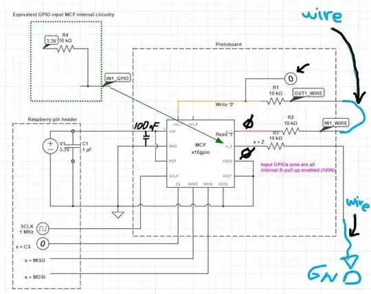

My circuit is too much simpler than those I have seen:
  1. 8 expander pins will be inputs. The rest will be outputs.
  2. Expander outputs will be writing '0', never '1'.
  3. Expander inputs has an internal Rpull up that put input at 3.3V when not connected.
  4. I put a wire at every output and this wire could be connected directly to the inputs or not. So when read the 8 input pins, those who are connected to the inputs will read '0', and the rest, will read '1'.
  5. An input would read these 3 scenarios:
    • '1' (when not connected),
    • '0' output writing (if they are connected)
    • '0' = GND (if a GND point makes direct contact with an input).
A particular characteristic of this system is that GPIOs will not be configured as inputs or output for the rest of the times. So during one execution a pin can be configured as an input during initialization, but at the next execution the same pin could be configured to be an output.
This overheating phenomena doesn't happens more than once or twice per day. But I'm afraid that once would be enough to destroy the system.
At final PCB design GPIOs pins will be traced through the board achieving a 64-pin connector. Input and output will be connected through a wire that will connect -or not- two of the 64-pin connector pins by human connection during execution. This way, a circuit between one input and one output could be closed. But there could also be open circuits between the rest of inputs and outputs.
I have added 10K Rs at every device GPIO and I'm using a 100nF between VDD and GND. It seems not to happen anymore two days ago, but I would like to ensure my GPIOs if the circuit really needs.
Does this circuit need GPIO protection? Are these resistor enough?

    If you did not have any bypass caps over the supply pins at the chip, that alone can cause all kinds of issues. But since you tried so many things at once, it is impossible to know what will help and what does not. I would have tried to figure out whether the two pins were accidentally set both to outputs, as then it is not a latchup caused by ESD, but maybe programming or communication error. – Justme Jul 29 '20 at 12:16
  • Ups! sorry I forgot drawing it, but there is a 100nF capacitor! so sorry! – Suvi_Eu Jul 29 '20 at 12:28

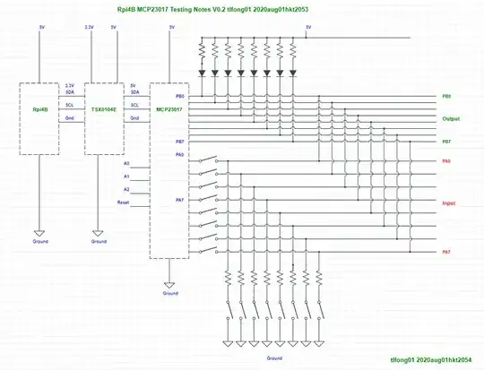

Part 1 - Test setup
I would suggest to start with a smaller version of the user requirements. For example, instead of making things very flexible, any pin can be input or output, you can in the testing phase, let 8 pins input only, and another pins output only.
PA0~7 set to input mode
PB0~7 set to output mode
Only when find the fixed input/output mode of the pins OK in testing, then you generalize the program.

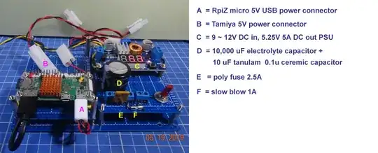

Part 3 - Recommendation to use external power supply for MCP23S17
I always recommend newbies NOT to use the Rpi's 5V or 3V rail to power MCP23S17 or other peripheral devices, but use an external power supply, at least for prototyping stage.
This way, if MCP23S17 gets crazy, the Rpi still sits happily. So I just manually reset MCP23S17 and no need to reset Rpi, the shows goes on.

(C.1) mcp23s17_test_2020jul3002 CircuitLab Schematic - tlfong01 2020jul3001
(C.2) mcp23017_test_v0.2_2020aug0101 PUBLIC tlfong01 2020aug01

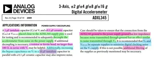

Appendix A - Bypass and Decoupling Capacitors - Robert Keim, AAC
(A.3) Clean Power for Every IC, Part 1: Understanding Bypass Capacitors - Robert Keim, AAC 2015sep21
(A.4) Clean Power for Every IC, Part 2: Choosing and Using Your Bypass Capacitors - Robert Keim. AAC 2015sep27
Introduction
It is not inconceivable that a dedicated, successful engineering student would graduate from college knowing almost nothing about one of the most pervasive and important components found in real circuits: the bypass capacitor. Even experienced engineers may not fully understand why they include 0.1 µF ceramic capacitors next to every power pin of every IC in every circuit board they design.
This article provides information that will help you to understand why bypass capacitors are necessary and how they improve circuit performance, and a follow-up article will focus on details related to choosing bypass capacitors and the PCB layout techniques that maximize their efficacy.
Solution
it is convenient that such a serious problem can be effectively resolved with a simple, widely available component. But why the capacitor? A straightforward explanation is the following: A capacitor stores charge that can be supplied to the IC with very low series resistance and very low series inductance.
Thus, transient currents can be supplied from the bypass capacitor (through minimal resistance and inductance) instead of from the power line (through comparatively large resistance and inductance). To better understand this, we need to review some basic concepts related to how a capacitor affects a circuit.
First, though, a brief note about terminology: The components discussed in this article are regularly referred to as both “bypass capacitors” and “decoupling capacitors.”
There is a subtle distinction here—“decoupling” refers to reducing the degree to which one part of a circuit influences another, and “bypass” refers to providing a low-impedance path that allows noise to “pass by” an IC on its way to the ground node.
Both terms can be correctly used because a bypass/decoupling capacitor accomplishes both tasks. In this article, however, “bypass capacitor” is favored in order to avoid confusion with a series decoupling capacitor used to block the DC component of a signal.

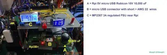

psu bypass, fuse
psu bypass cap
psu power switch

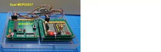

Appendix C - Old MCP23S17/ MCP23017 Proto Board for Testing

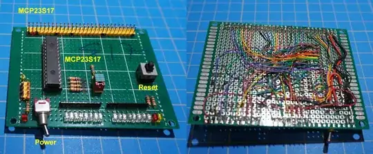

I am thinking of using my old MCP23S17 or MCP23017 to do some tests. Looking at the messy wiring of my old MCP23017 board, now I remember why last time I gave up working on SPI MCP23S17 and switched to I2C MCP23017, because the DIY wiring is very messy, and difficult to do hardware troublshoot. For I2C MCP23S17, there are cheapy breakout borads, sayhing me much time doing wiring.
mcp23s17 wiring
mcp23s17 board

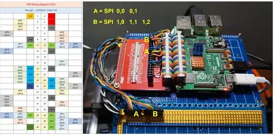

mcp3s17 set up
rpi4b spi 1
rpi4b spi setup 1
spi loopback test 1

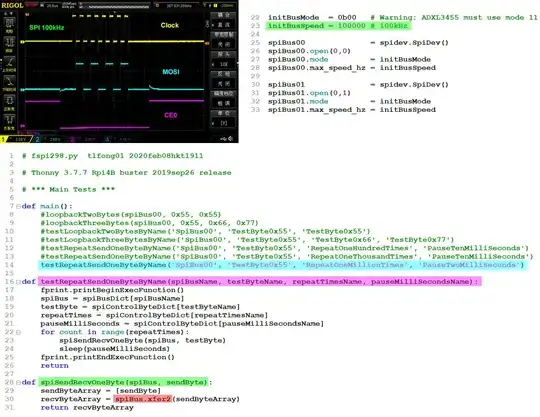

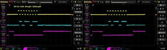

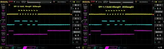

Appendix E - Testing SPI 00, 01, 10, 11, 12 Loopback and repeat send one byte OK
# Program:
#   spi_loopback_v55.py  tlfong01  2020aug03hkt1220
# Function:
#   1. SPI one byte loopback
#   2. SPI repeatedly send one byte

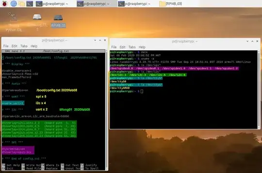

1. SPI ports setup notes
To enable SPI and setup SPI 10, 11, 12 ports, add these two lines to /boot/config.txt
dtparam=spi=on
dtoverlay=spi1-3cs
To list SPI devices
pi@raspberrypi:~ $ ls /dev/spi*
/dev/spidev0.0 /dev/spidev0.1 /dev/spidev1.0 /dev/spidev1.1 /dev/spidev1.2

Appendix F - Repeat send byte scope screen captures
repeat send byte 1/3
repeat send byte 2/3
repeat send byte 3/3
Appendix G - Dual MCP23S17 Proto Boards Setup
dual mcp23s17

    Yes, one more reason of not using Rpi's 5V power rail is: (1) If you set many MCP23S17 GPIO pins with big loading high at the same time, there will be a sudden big draw of current, causing a dip at the Rpi power rail, say if lower than 4.5V, Rpi might go crazy and anything can happen. You see I am using a very big cap, 10,000uF by pass capacitor to keep the power supply from fluctuating. (2) One trick you can do is not to switch on/off GPIO pins all at the same time, but *sequentially, pause 1~10 millisecond one after another*, so the big current rush will be many times smaller. – tlfong01 Jul 31 '20 at 12:57
    You might also notice that I am using voltmeter to monitor the power supply, polyfuse and slow fuse to protect over current, and the red power switch, which is sort of "the railway train driver's dead man's handle," Whenever I smells burning plastic, or white smoke rising, I will flip the red switch as fast as lighting, like the kung fu fighting guy.https://www.youtube.com/watch?v=jhUkGIsKvn0 :) – tlfong01 Jul 31 '20 at 13:49
