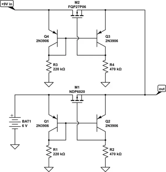

As well as wanting very low voltage drop in battery backup mode, in the comments you say
the mains supply's output is 9V nominal, and I want to have as much of that available as possible
The obvious solution is to combine the power sources through 2 'ideal diodes' which have very low voltage drop. If a dedicated IC is not acceptable then you could use discrete transistors instead. The circuit is similar to the one shown here, but with higher value resistors to reduce quiescent current draw.
schematic
R1 (R3) is made a lower value than R2 (R4) to make the Base-Emitter voltage of Q1 (Q4) slightly greater than Q2 (Q3), causing Q2 to turn on and keep the FET turned off until the 'ideal diode' drops a small 'forward' voltage. To ensure that this works reliably the transistors should be thermally coupled and well matched.
For a one-off circuit you could use unmatched transistors, but test the circuit with a small load current and swap them around to get the highest 'forward' voltage drop across the FET. This should ensure that it turns off promptly with negative bias, though in your application it may not be critical.

  • BTW: I got a "blip" of reverse current into the battery at startup in my LTspice sim of this circuit with R1=R2=750k, is that a sign there's an upper bound on the resistance values used in this circuit? – ThreePhaseEel Jul 26 '20 at 14:20
    The higher the resistance of R2 the slower the FET turns on, due to Gate capacitance. Normally Q2 turns on quickly as it amplifies current supplied by R1, so the FET turns off quickly (before the other one turns on), but with very high R1 value Q2 also takes longer to discharge the Gate so the FET turns off slowly, causing a blip of reverse current when both FETs are on together. Assuming the power isn't switched very often this short blip shouldn't be a problem. Leakage through the FET may put more charge into the battery in the long term. – Bruce Abbott Jul 26 '20 at 21:27
  • I did some more simulation work in LTspice and found out one caveat about this circuit -- if BAT1 is connected backwards with the 9V rail powered up, then Q1's B-E junction gets hit with oh, 18V of reverse bias = bye bye Q1 – ThreePhaseEel Feb 16 '24 at 05:00
  • So don't do that. Connecting a battery with reverse polarity is fatal to most electronic devices. If you can't avoid that possibility then a resistor between Q1 and Q2 Base (eg. 10k) would limit reverse b-e current to a safe level. – Bruce Abbott Feb 17 '24 at 20:50
  • Yeah, while you and I can be counted on to not hose things up, end users aren't so reliable :P (and some product standards call for testing the product vs. reverse battery conditions). I'll keep the resistor in mind if whacking 1N4148s in series with the emitters of Q1 and Q2 doesn't do the trick – ThreePhaseEel Feb 17 '24 at 22:58
  • Update: pulling the input to about -6V with my bench supply with about 4.5V of output bias (5V 3A wall-wart with a 3A Schottky in series to protect it) led to about 0.9A of reverse current and a distinct magic smoke odor. Adding the diodes in series with the emitters fixed the problem, with no reverse current flow and 4.3-4.4V of output for a 4.5V bias and up to -27V on the input. – ThreePhaseEel Feb 24 '24 at 01:42
