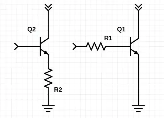

TL;DR answer:
A resistor in front of the base (as you suggested) does compensate for drifts in the applied base voltage.
However, the typically used emitter feedback resistor compensates for current changes due to varying base-emitter voltage of the transistor, which in general is the thing you want to compensate. A series resitor in the base will not provide this compensation!
Also the emitter current is much higher, in fact an amplified amout of the base current, and therefore creates much stronger feedback.
Furthermore, a high series resistor in the base path would significantly worsen the gain of the amplifier, due to the Miller effect at high frequencies.

Consider the follwoing two configurations: Transistor schmeatics
The right version is the one you proposed. Let's run the numbers: Assumptions:
  • Constant base emitter voltage of 700 mV
  • Resistor 100 Ohm for the right schematic and 1 Ohm for the left schematic
  • Applied base voltage 0.8 V
  • base current amplification: 100
Right schematic
I'm sure you can calculate for yourself, that under the above assumptions, the base current is 1 mA and therefore the collector current is
$$I_C\bigg|_{V_{B} = 800~\mathrm{mV}} = 100~\mathrm{mA}$$.
Now let's assume a a base voltage increase of 10 mV: The base current will now be 1.1 mA which results in a collector current of:
$$I_C\bigg|_{V_{B} = 810~\mathrm{mV}} = 110~\mathrm{mA}$$.
Left Schematic
Assuming the same values for the transistor, the voltage over the resistor will be 0.1 Volt, resulting in a collector current of
$$I_C\bigg|_{V_{B}=800mV} = 100~\mathrm{mA} $$.
The same increase of 10 mV applied base voltage results in:
$$I_C\bigg|_{V_{B}=810mV} = 110~\mathrm{mA} $$.
As you can see: The effect of the resistors is the same in this case, however the one needed in the emitter path must only be one hundredth the size of the one in the base path for the same result. (the factor 1/100 comes from the current amplification of the transistor, which I assumed to be 100).

2mV change in base-emitter voltage can lead to tremendous current fluctuations. Considering the right side schematic above:
Your proposed circuit (right schematic)
If the base-emitter diode becomes more conductive, the base node voltage will drop, essentially drawing more base current through the resistor and therefore also increase the collector current. This behavior is unwanted!
Working compensation (left schematic)
Consider the left schematic: If the base emitter diode becomes more conductive, the base current will raise, so will the collector current and the emitter current. This creates a higher voltage drop over the resistor, which is raising the emitter voltage of the transitor, and therefore reducing the base-emitter-voltage, which will give negative feedback to the base current and therefore limit the current through the transistor. The circuit is now compensated and will have a much lower temperature dependency than the other one.
