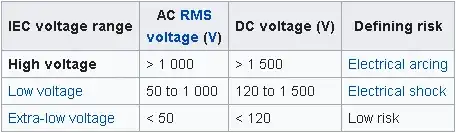

The following chart and paragraph are from wiki/High_voltage
The International Electrotechnical Commission and its national counterparts (IET, IEEE, VDE, etc.) define high voltage as above 1000 V for alternating current, and at least 1500 V for direct current—and distinguish it from low voltage (50 to 1000 VAC or 120–1500 VDC) and extra-low voltage (<50 VAC or <120 VDC) circuits. This is in the context of building wiring and the safety of electrical apparatus. In automotive engineering, high voltage is defined as voltage in range 30 to 1000 VAC or 60 to 1500 VDC.
