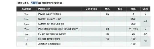

Chapter 32 of the data sheet says the absolute maximum voltage allowed is 4V, so they won't promise that it will survive 4.2V
Stresses beyond those listed in Table 32-1 under may cause permanent damage to the device. This is a stress rating only and functional operation of the device at these or other conditions beyond those indicated in the operational sections of this specification is not implied. Exposure to absolute maximum rating conditions for extended periods may affect device reliability.
enter image description here you might get lucky.
