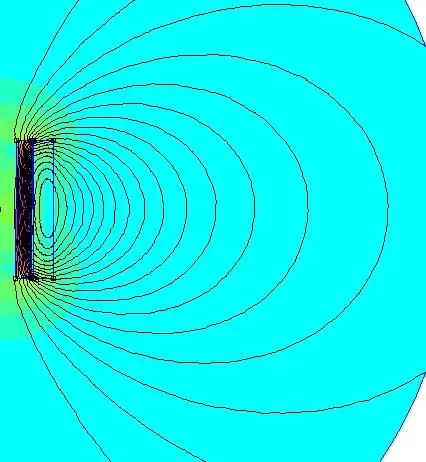

I'm adding this in an answer just so i can show the graphic - the results seem to agree with how Andy explains it in his answer and subsequent comments (Charles answer as well). I did this model in the free 2-d FEMM software. I started with the .fem file from this neat page and watched this video to learn how to use the simple program.
The clear rectangle is one side of the current carrying coil that wraps around the inner hollow cylinder. The inner hollow cylinder is M-19 steel. Inside the hollow cylinder (far left) is air. If you take the mirror image of this and place it on the left you can imagine a 2-d view of the full thing.
The magnetic field lines really pack into the low reluctance cylinder, much less in the air in the hollow. My first look at FEMM, seems like great tool. Also, all the blue is air.

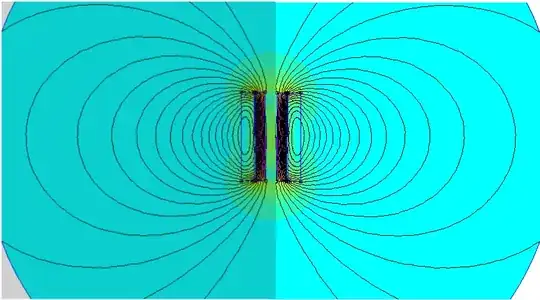

EDIT: In the image below i created a mirror image and stuck them together. If you imagine a vertical field line in the center i think you would have a fair understanding of the field (at least this 2-d slice).
