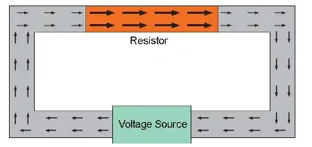

In the context of classical electrodynamics, it's surface charge.
You should first ask yourself "what makes the electric field follow the path and shape of the conductor?" Well, it is surface charge. The battery generates an electric field nearby it, when you place the conductor near to it without connecting it to the battery, the free charge in the conductor will feel the field and will reposition itself of the surface of the conductor in order to make the electric field inside zero. This is just plain electrostatic induction.
Let's consider a cylindrical conductor of conductivity sigma with different cross sections. When you connect the conductor to the battery, the charge will change its configuration in order to make the field inside the conductor conform to local Ohm's law j = sigma E. If you solve Maxwell's equation adding in the continuity equation and a pinch of Ohm's law in its local form, you will find that the charge density in the system will depend on gradients of conductivity and permeability:
charge density depends on gradients in sigma and epsilon
This means that there will be rings of charge around the cylinder that will shape the field to follow the conductor, and there will be charges at the discontinuity in section to make the field 'concentrate' or 'dilute' according to cross section.

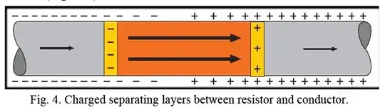

This is a resistor made of a material of different sigma
resistor made of different material
in this case the different field is caused by surface charge at the interface between materials
different sigma causes surface charges at the interface
(picture from the same paper above).
In the case of a resistor made of the same material but different section you would have surface charge at the surface required to change the section's diameter. Those charges will steer the field lines inside the smaller section. Sigma is the same but both j and E will rise. When you integrate the field along the path you will find a higher potential difference.
