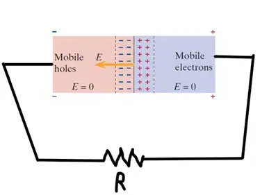

Now, I wish to connect the ends of this diode with a conducting wire and resistance like this:

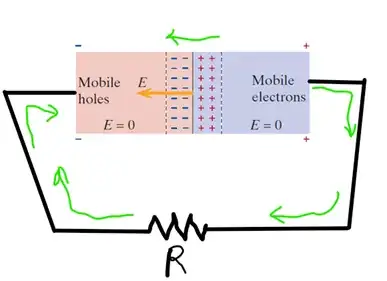

Thus, I expect the electric field in this space to be aligned as follows (indicated dim green:)
This will make the charges in the wire accumulate in the following way:
Finally, this system will end up neutralizing all the charges so that no electric field remains inside and outside the diode; creating equilibrium state for the free charges. So, we are going to be back on a simple P-N junction diode with no depletion region and no electric fields.

This circuit has three dissimilar materials: two doped semiconductor regions, and a wire (we can allow the resistor to be a wirewound type, so it's just... part of the wire).
That means there are three junctions. While the metal joints are perhaps not semiconductor diodes, they ARE subject to the same charge-diffusion boundaries at the joint, and even between metals, there is a known effect (thermocouple or Seebeck effect) due to charge migration at that boundary.
So, the total circular sum of voltages across those three junctions might be zero, but none of the individual junctions is exactly zero voltage. In fact, if the joints are at different temperatures, you'll get a net thermocouple effect, and current may flow through the resistor. It's a heat engine, though, and not a perpetual motion solution.

The process you are describing equalizes the Fermi level across the junction. Connecting wires equalizes the Fermi levels of the wires. The relative Fermi level is what a voltmeter reads, so a voltmeter connected in place of your resistor would read zero volts. There is no voltage to drive a current through your resistor.
The detailed physics here is a bit mind bending: even those of us who do things like chip design get confused sometimes. Wikipedia has an excellent article on this.

If you take the field from any point-like charge -- an electron or hole -- and integrate it around any loop, the total field along the loop will add up to zero.
The field from any distribution of such charges, integrated around a loop, is the sum of the field from all of the point charges. They all sum to 0 individually, so you get 0 when you add them all up.
So the real answer to your question is easy: It doesn't matter what kind of charge distribution you have -- a static charge distribution doesn't push electrons around any loop.
In this case, you forgot to count the voltage drop across the PN junction.

  • See that green arrow you drew at the top? It opposes all the other ones. Causing an electron/hole recombination across the depletion region get costs energy. In a solar panel, that is provided by the incident light. – Matt Timmermans Jul 06 '20 at 13:18
