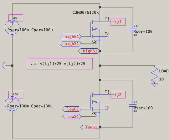

I already received a few tips from user 'a concerned citizen', but decided to start a separate question.

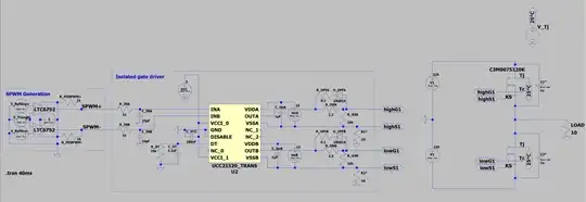

This is the schematic: Schematic
This simulation takes about 1:10 to complete the first 8.6 ms on a fairly high-end CPU, after which I get a timestep too small error.
Here's what I've already changed based on what 'a concerned citizen' mentioned:
  • Added a series resistance to every voltage source, except the one used to set the MOSFETS' temperatures because I didn't know if this was necessary.
  • Changed the sawtooth wave to a triangle wave for the SPWM generation.
  • Changed R_OFFA and R_OFFB from 0 Ω to 0.1 Ω.
  • Changed D_OFFA and D_OFFB from a 'generic' diode to the 1N5819.
  • Added C1* and C2*.
I also added R1* and R2*
I'm using * to mark components that are there just to try helping the simulation.
I also tried adding 2 options:
.opt gshunt=1g makes the simulation complete in about 2 seconds, but it makes the output waveform (at the load) look like this: With .opt gshunt=1g
.opt cshunt=1p makes the simulation run really slowly, it basically gets stuck about 140 ns in.
My questions:
'a concerned citizen' mentioned uplim(dnlim(...)) is superior over limit(). Does this mean I should just go through the .lib files for the UCC21520 and the MOSFETs and just swap all of them? Which value should I use for z, the soft limiting zone?
He/she also wrote this in a comment:
The subcircuit for the driver (and the power transitors) are not very convergent-friendly: lots of if() on stiff voltage sources, plus hard limit() on same voltage sources. You could try to improve the model yourself: 1). find all the VCVSs with conditionals and replace them with their VCCS equivalents, but with reversed pins (i.e. 0 x instead of x 0), and add a 1n rpar=1 cap in parallel, or 2). replace those same sources with the equivalent A-devices (i.e. if(V(x),1,0) replaced by a [Digital]/buf with x as input). The 1st is SPICE compatible, the 2nd will only work in LTspice.
But I simply don't understand what most of this means and whether I should go with option 1) or 2). I'll include both .lib files at the end, it would be nice to get an example of what exactly I'd need to change.
Other suggestions are of course also welcome.

    .opt gshunt=1g. gshunt seems to be a 1/resistance added from each node to ground. gshunt = 1g means a resistor of value (1/1e9) is connected from each node to ground. Basically you have shorted ALL nodes to ground. gshunt should be set to very small values to prevent too much current from leaking from each node to ground. – AJN Jul 04 '20 at 17:10
  • I made these small changes: make V_triangle=5.1 (was 5.01, the modulation index was too high), made R_ONx=10 (was 2.2) and R_OFFx=1 (was 0.1), Rser=100m for both V1 and V2, added Rser=1m to V_Tj. It seems to work, slow, but it does, stopped at ~20.7 ms, lots of DefCon messages in the error log, but they can be ignored (expected, frankly, given the models). No gshunt or cshunt (but @AJN is right about the gshunt; default is 1p IIRC, try 1n if it's needed). – a concerned citizen Jul 04 '20 at 17:21
  • @aconcernedcitizen I made these changes and it's getting stuck at 3.5 ms. Could it have something to do with a difference in spice settings? These are mine: https://i.stack.imgur.com/5JQPK.png – Cedric Jul 04 '20 at 18:49
  • Those are the default settings, just like mine. Did you delete or comment out the gshunt and cshunt settings? cshunt in particular seems to be causing problems, but I did not use any of them. I just let it run until the end, and it did. Also, despite the library for the UCC stating that the dead-time is modeled, it doesn't seem to work. If you think you'll see actual, real-life waveforms in the simulation simply because you're using models for what you plan to use, you'll be disappointed. Try this if you just want waveforms. – a concerned citizen Jul 04 '20 at 19:25
  • For even more safe settings increase the triangle to 5.25 V, to make the modulation index a more reasonable 0.95, and make the period 30 us (15+15), for a slightly faster simulation. – a concerned citizen Jul 04 '20 at 19:27
  • Why do you have the 33p caps? Hard to say what the effect is, but a 1.6ns time constant can't help. – copper.hat Jul 04 '20 at 20:06
  • @aconcernedcitizen Just skimming these last few seconds. The first thing that pops to mind is the use of E sources. LTspice help has some recommendations for replacing those which will impact simulation. Just a reminder. – jonk Jul 04 '20 at 20:46
  • @aconcernedcitizen Yes, that was without gshunt or cshunt. I tried with gshunt both 1p and 1n but it only got worse. The reason for simulating this is that I wanted to get an idea of the dissipation in the mosfets and for designing an lc filter which works at different loads. Filter is the next step but I first wanted this to work. I can get it to complete the simulation (in 13 mins..) if I use the alternate solver and .opt gshunt=1u, will the gshunt of 1u have a big impact on the results? From what I can tell, it doesn't. Do you think changing the limit() functions will help? – Cedric Jul 04 '20 at 21:34
  • @aconcernedcitizen I suppose I could get rid of the whole gate driving part, create 2 separate, floating spwm generators and connect them directly to the mosfets for further testing. To simplify the circuit. – Cedric Jul 04 '20 at 21:36
  • Get it working with a simpler model first. – copper.hat Jul 04 '20 at 21:49
  • @copper.hat Those rc-filters aren’t necessary in the simulation. Only if the signal has to go through long pcb traces. 2nd comment: Do you mean a simpler mosfet model? – Cedric Jul 04 '20 at 21:53
  • They are adding unnecessary state and the fast time constant will hinder time domain analysis. – copper.hat Jul 04 '20 at 21:55
  • @jonk Yes, in a separate question from OP I did mention in the comments that the models have both if() and stiff voltage sources, which don't look very encouraging. – a concerned citizen Jul 05 '20 at 07:46
    Do you have control over the integration method? If so, try Gear. – copper.hat Jul 05 '20 at 07:57
  • @copper.hat It doesn't fix it but sometimes it helps to run faster/with fewer errors so I guess it's another trick I can try to use when something's getting stuck. – Cedric Jul 05 '20 at 21:01
  • @Cecemel: I would simplify the circuit considerable, get it simulating and then add complexity. – copper.hat Jul 05 '20 at 21:09
Only now I see that you're forcing a voltage on the Tj pins, but those pins, together with Tc, are meant to output the temperature, and be separate. You need to delete that source, rename the two nodes separately, say tj1 and tj2, then add initial conditions that represent the initial junction temperatures (which will always be greater than Tc = case temp); e.g. .ic v(tj1)=25 v(tj2)=25.
You can drive the SiCs as you do now, but for the purpose of the simulation, you can tie both sources together.
One last attempt from my part was to try to convert limit() to dnlim(uplim()) inside the subcircuit, but it doesn't seem to work, so I just eliminated the limit() from all sources. It now works, but you should take care not to exceed specifications, since that's what those limits enforced.
Not lastly, you are using a 325 V supply which is meant to represent the peak voltage for 230 V, and perhaps that's why you used such a high modulation index: 5 Vpk for sine, 5.01 Vpk for triangle => m=Vsin/Vtri=5/5.01=0.998. In practise, the DC link is usually 350-400 V to avoid very narrow or very wide pulse widths, i.e. keep m around 0.9, 0.95 max if you can afford it. This may be similar to a class D amplifier, but it's really not, it's a power inverter.
With these in mind, the triangle source has now 6.15 V, the half-bridge supplies are both 400 V, the sources for the SiCs are joined (can be left separated), V_Tj is deleted and the nodes separated into tj1 and tj2 with .ic:

a concerned citizen
  • 21,445
  • 23
  • 40
  • I'll just add that the SiC subcircuit is not good, either. This simple setup gets stuck as you can see, and the one without limit() just hangs around a few us with lots of oscillations. Either choose a different model and hope for the better, or use a regular VDMOS and try to squint when reading the values. – a concerned citizen Jul 05 '20 at 09:15
  • I thought it was ok to connect a voltage source directly to the Tj pins given page 7 of the documentation for the mosfet models (I should've included that in my post): https://gofile.io/d/CUxBNX What exactly will happen if I exceed the specifications, compared to what used to happen? Will the model no longer behave accurately outside the specifications? I made the modifications you made and am using the modified library, but I'm getting a big negative spike on tj2 followed by an error: https://i.imgur.com/19JdzQG.png Thanks for the help though. – Cedric Jul 05 '20 at 20:51
  • @Cecemel You're right, my apologies. I deduced that based on reading the subcircuit. Still, their pdf leaves to be desired since fig. 9 shows a 1n cap across the GS of each (why?!), and a supply with explicit Rser=0 yet a cap across it, which is completely useless (why?!). They also say that either Tj or Tc must be connected, so with Tc connected the simulation seems to go a bit faster, but still won't work with their default library, compared with the one without limit(). Try this (copy-paste and rename as .asc), the differences will not be that big. – a concerned citizen Jul 06 '20 at 07:31
  • Also, this is the reworked schematic, it seems to run until ~20 ms, when it gets stuck. I honestly don't feel very inclined to fix their models, particularly since, if I replace the SiCs with regular VDMOS, it runs. It looks like the PWM controller is doing fine enough, which I can't say about the models for the SiC. Granted, the technology currently doesn't seem to have an intrinsic model, so it has to rely on scary behavioural expressions. Also, the Tj/Tc could be solved with initial conditions, adding a source just forces a constant voltage. Oh well... – a concerned citizen Jul 06 '20 at 07:35
  • Forgot to add: for the SiC subcircuit, use whichever library runs better, the original or the modified one, though the latter, even if it seems to run, it doesn't run accurately, most likely, internally, there are some quantities that exceed the limits and the other formulas don't like it. Better to use the original. If that doesn't work, try another SiC, maybe that works? – a concerned citizen Jul 06 '20 at 07:40
  • I’ve simplified the schematic by replacing the whole gate driver circuitry by 2 voltage controlled switches that switch 15v sources on/off across the gates/sources and it still isn’t working. Without the mosfets, it runs quickly and without errors but once I add them, I get a timestep too small error after a few ms. Not a surprise, though, given the simple testcircuit you made didn’t work either. I’m going to send that schematic to Wolfspeed to see if they can help, no high hopes though. – Cedric Jul 06 '20 at 08:06
  • I’ll accept this answer for the help I’ve gotten from you and because I don’t think I’ll get any more useful answers, the problem just seems to be a bad model. For now, I’ll probably replace the Wolfspeed mosfets with something else so I can focus on output filter design. – Cedric Jul 06 '20 at 08:06
