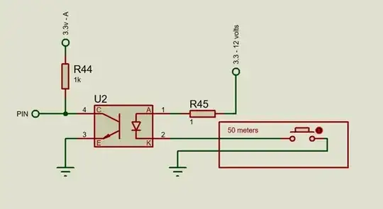

How do you choose the series resistor value for the LED side of an optocoupler. My application uses this opto to interface a button that is about 25meters(50 meter wire roundtrip) away from the device.
For choosing R44 or the collector pullup was pretty easy since the datasheet has provided a 1k. On the other side however there is no mention of a resistor. I would like for the led to be able to take inputs from at least 3.3 to 12volts.
And having a look at the input characteristics of from the datasheet the maximum forward current is 60 mA(for a typical LED this is very very large). What would be the minimum current of the LED for so that the PIN can still safely register an "ON" state. Would a higher current(lower value resistor) on the led (30-40mA) be safe for repetitive use?
Going further, to skip using a voltage regulator (it will come from mains anyway) is it possible to use the mains voltage 240 VAC instead since the optocoupler is capable of using AC anyway. How would I choose my resistors then ?

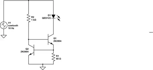

  • Jake, one thing I personally like to do is use a current source/sink and not a resistor. – jonk Jul 02 '20 at 20:57
If you want to accommodate a wide range of voltages, the easiest thing to do is to increase the resistance at the phototransistor so it will work at lower currents. I would not go over about 15mA, LEDs age and will eventually drop in brightness to the point where the CTR is not high enough to work. Speed suffers approximately proportionally, but that's not so much a concern with a manual pushbutton.
The next simplest thing is to add a constant current circuit to the input. For example:
schematic
By adding a couple pennies worth of parts, the current is typically maintained fairly constant from about 2V to 25V (at room temperature).
In either case you want to have a lot of margin (maybe 2-3:1) to make sure the transistor saturates and to allow for normal aging. The output current is 3.3mA so if your minimum CTR is 100% you might want 10mA nominal at the LED. That would lead to excessive current with 25V in and a simple resistor R = (3.3V-1.2V)/0.01A = 210\$\Omega\$ so at 25V you'd have 108mA (but not for long).
If you allowed only 15mA at 25V in that would require about a 1.5K resistor, so the current at 3.3V would be only 1.4mA so with a CTR of 100% you'd want more like 7K at the output. Maybe 2K and 10K would be acceptable, again assuming a nominal CTR of 100% minimum over the LED current range of 1~10mA.

    Oh, crap. You just did what I was thinking. Okay. Thanks! +1 (for what it's worth.) Can you make the schematic a little smaller, though? Like add tiny 10-point periods to either side of the darned thing? (Also, to the OP, see here for an expanded discussion.) – jonk Jul 02 '20 at 20:58

  • If you dont mind me asking sir, i am interested in this method. How would this fair with ESD strikes(since long cables are likely to get one) the optos themselves are protected but will these parts be fine? How do you choose the R1 and R2 you did mention some resistor value but i do know where they will go – Jake quin Jul 02 '20 at 22:12
  • You would be best to put a diode (eg. 1N4148 across the LED) or the current source plus LED to protect against reverse bias. R1 determines the current (current is about .7V/R1). R2 has to be low enough to give the transistor enough base current to turn on, but too low wastes too much power. Your circuit has only two resistors, one for the LED R45 and one for the phototransistor R44. R45 limits the LED current, the second, the pullup is also discussed above. – Spehro Pefhany Jul 02 '20 at 22:57

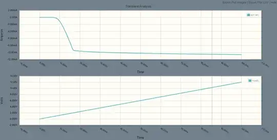

  • I tried to simulate you circuit even went to 50volts. So i assume if i want to go higher voltages i must make sure that the transistors can dissipate the extra heat. I found a post by @jonk on another question which tells how to calculate the resistors. I tried setting it at 30mA take a look if i have done it correctly – Jake quin Jul 02 '20 at 23:04
  • Yes, it's correct, but I would not use such a high current because of LED lifespan. Lower current will help with the transistor dissipation as well, of course. – Spehro Pefhany Jul 02 '20 at 23:15
  • Yes, i plan to keep it at 10mA, the 30mA was just a practice number to check if i was able to calculate the resistors out. Back to ESD protection, this optocoupler already has them, but would the transistors be just fine? – Jake quin Jul 03 '20 at 00:35
  • A diode is cheap insurance. – Spehro Pefhany Jul 03 '20 at 00:41
  • where would the anode and cathode of the diode be? wont the ESD happen on the very long wire. Now that i think about it in your schematics where would the long wire section be ? right after the LED? Q1? or R1 ? or heck before the LED? – Jake quin Jul 03 '20 at 01:33
These devices usually spec a current transfer ratio which makes it hard to determine how the LED is actually working (it would be better if they gave a curve for the LED).
With LED's more current can cause lifetime issues, so it's best to stay at the nominal value. In their testing diagrams they used 10mA, I would stick with that. If you were running into issues on the transistor side with it not turning on, then I could see needing to get a better current transfer ratio, but it looks like you can also set R44, so that would be a better way to adjust the transistor current.
So if you use 10mA and a forward current of 1.15V with a 3.3V Vcc then you'd need a V drop on the resistor. V/I = R
so 2.15V/0.01A = 215Ω
For (12V-1.15V)/0.01A= 1085Ω
On the transistor side, it really depends on what the transistor of the opto is connected to. The resistor needs to source more current than the load (whatever pin is connected to). For most microprocessors 20k or 10k is plenty.
Source: https://www.vishay.com/docs/83653/ild620.pdf
As far as connecting the LED directly to mains, it's not safe. At minimum need an isolation transformer. You could use a step down transformer. The problem with connecting the LED side to an AC signal is if you push the button down and turn the LED on, it will cycle at the mains frequency and turn on and off rapidly, if you don't want this to happen the best way would probably be to use an LDO.
