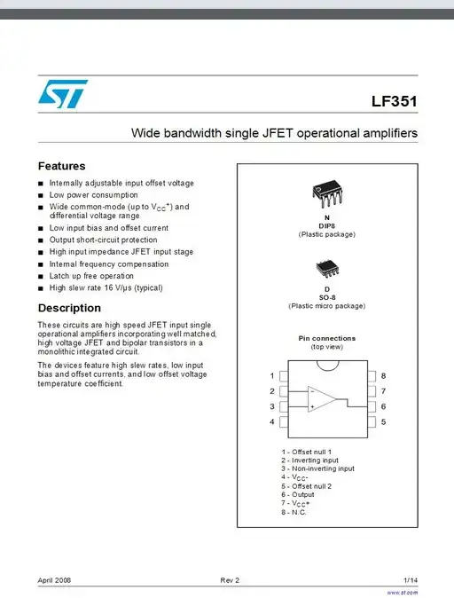

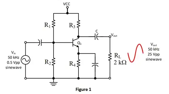

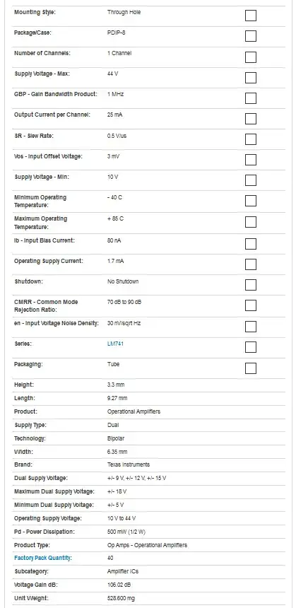

Ok, so I am designing an amplifier using an op-amp to produce the same undistorted output sinusoidal wave across a 2Kohm load as that of the common emitter amplifier shown in the attached picture. I have researched online on what specific op-amps I can use and cannot decide whether I should use an LM741/A or LF351 op-amp. The other pictures attached are the datasheets for both op-amps. Any advice on which op-amp I should use? That will be greatly appreciated. LM741 LF351

You might want to start by comparing the slew rates. A 50 kHz 25 Vpp waveform requires 8 V/us. One opamp offers 16 V/us, the other 0.5 V/us. So one is just marginally suitable, the other entirely unsuitable.
However, there are plenty of other reasons to avoid 741.

  • How did you calculate that the waveform requires 8V/us? I used the formula Fmax=SR/2pi*Voutpeak. Unclear on that – Wetyyjs Jul 02 '20 at 06:14

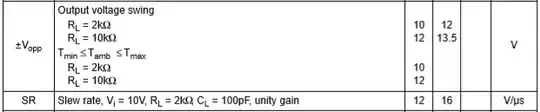

You're near the limit for Output voltage swing with LF351.
With a \$\pm 15V DC\$ supply, typical output swing is \$\pm 12V\$.
You'll need to power the opamp with rather high voltage DC supplies to achieve 25V p-p output. To meet your requirement, you'd likely want higher supply voltage, but the absolute upper limit is \$\pm 18V\$:
output voltage swing LF351
Not even going to contemplate using a LM741 @ 50 kHz.

  • Just to clarify, so a +-18V supply voltage is suitable to achieve a 25V p-p? – Wetyyjs Jul 03 '20 at 15:57
  • You have a little range to play with. $\pm15V$ gives you 24V output pin swing (if you're lucky). So you need more than $\pm15V$ supply....but never more than $\pm18V$. Can you ensure that your supply never exceeds $\pm18V$, even for a moment? The DC supply should also not sag under load - its equivalent Thevenin resistance should be small. At 50kHz, large capacitors on the supply may help. I'd want DC supply to be close to $\pm18V$, and look closely at its error budget. – glen_geek Jul 03 '20 at 16:10
  • If a DC supply of $\pm15V$ guarantees a swing of 10V into 2k load, then you might assume that 5V is dropped inside LF351. With a higher supply of $\pm17.5V$, this same 5V overhead gets you close to a swing of 12.5V at the output pin. I'd want a bit more than $\pm17.5V$, but never at any moment more than $\pm18V$. That's a tight spec on the DC supply. – glen_geek Jul 03 '20 at 16:23
  • Ahhh I see but what is the reason for wanting a voltage a bit more than +-17.5V ? – Wetyyjs Jul 03 '20 at 16:27
  • I've extrapolated that 5V overhead directly - that's not fair because output current and peak current will be higher when driving that 2k load with 25v p-p instead of 20v p-p. You're right - the spec sheet is a little sparse regarding the overhead @ various DC supply voltages, but you can be assured that you need a bit more overhead than 5V. – glen_geek Jul 03 '20 at 16:41
  • So what do you suggest the supply voltage be? And what is the value of Vsat, is the output swing equal to Vsat? Because an undistorted output waveform is desired and the voltage swing should not be more than Vsat – Wetyyjs Jul 03 '20 at 16:46
