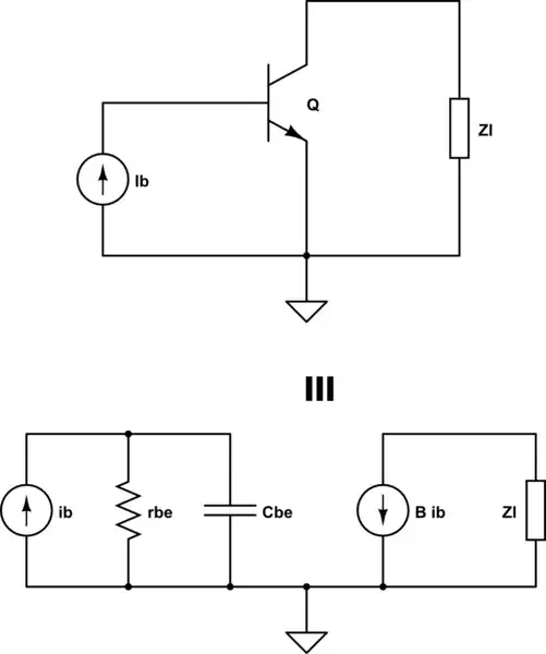

Not a full answer, but a contribution to a possibly complete one.
As @Neil_UK alludes in his answer, frequency response is a matter of concern in properly designed amplifiers. To fix ideas, let's consider the simplest common emitter amplifier BJT stage: if you drive it with a high impedance generator, ideally a current source, you are in the following situation:
schematic
The part of the \$i_b\$ current which effectively controls the \$i_c=\beta\cdot i_b\$ current is the one which flows in the base-emitter resistance \$r_{be}\$, which is shunted by the base-emitter capacitance \$C_{be}\$. Thus there is a high frequency pole in the input circuit of the amplifiers which limits the overall bandwidth of the circuit. And now the question is: How this pole influences the global bandwidth?
The value of \$r_{be}\$ could be (and usually is) in the \$\mathrm{k}\Omega\$ range, while in the data sheets you see a \$C_{be_o}\$ which is of the order of few \$\mathrm{pF}\$ (or less): so why this pole should concern us?
This is because the real capacitance of the input of the BJT is far larger: precisely, $$ C_{be}\simeq C_{be_o} + \frac{\mathrm{d} Q_{b}}{\mathrm{d} v_{be}}\label{1}\tag{1} $$ where \$Q_{b}=\tau_b\cdot I_c\$ is the total base charge. The second term on the right side of the expression \eqref{1} has the following form $$ \begin{split} \frac{\mathrm{d} Q_{b}}{\mathrm{d} v_{be}} &\simeq \tau_b \frac{\mathrm{d} I_{c}}{\mathrm{d} v_{be}} = \frac{\tau_b I_{EB}}{V_T} e^\frac{v_{BE}}{V_{T}} \\ &\simeq \tau_b g_m v_{be}\; \;\text{ if } v_{be} \text{ is "small"} \end{split},\label{2}\tag{2} $$ where
  • \$\tau_b\$ is the base minority carrier lifetime,
  • \$I_{EB}\$ is the emitter base junction saturation current
  • \$g_m=\frac{I_C}{V_T}\$ is the BJT forward transconductance.
When the BJT is biased in forward active region, the common values of the listed parameters are such that \eqref{2} is the dominant term in \eqref{1}: this implies that the base circuit of a common emitter BJT amplifier has a very slow frequency response when driven by an ideal current generator, and this limits the overall frequency response of the amplifier in an essential way. Note also that the capacitance \eqref{2} is highly nonlinear, thus the bandwidth response is low and decreases as the input voltage increases, thus making the also the low distortion goal vanish.
Conclusions
  • The frequency response of a BJT driven by an ideal current source is severely limited by the structure of the input pole of the BJT itself. Thus the relative linearity of the gain is usable only at low frequencies. If you drive the same BJT with an ideal (in practical a low impedance) voltage source, then \$r_{be}\$ is (almost) short circuited, thus the frequency response of the input circuit can be vastly improved.
  • The input capacitance of a forward-active biased BJT is highly nonlinear: as a matter of fact, its main component behaves exponentially respect to the base emitter voltage \$V_{BE}\$. This especially significant in large signal circuits, where it would be also advisable to achieve the best low distortion performance. Thus, even if the relation between \$I_C\$ and \$I_B\$ is nearly linear at DC, as the frequency and the driving voltage rise, a number of frequency dependent nonlinear phenomena will appear, making the linearity advantage of an ideal current generator driving vanish.
