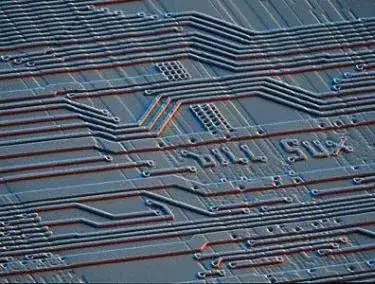

There's an urban legend that some version of Intel Pentium chip had "Bill sux" caption somewhere on the circuit. The legend is accompanied with this picture:
Now let's assume for a moment that the legend is in fact true.
How realistic is the picture? Specifically why are all the elements of the same color? Why don't traces differ in color from the surroundings?

    If it is a picture taken with an electron microscope you can't expect natural colors. As much as I know a EM only provides intensities (Of course the output can be transformed somehow into a colored picture) – Curd Dec 06 '12 at 11:50

  • Why bother with color. If this is inside a chip, why are drill holes there? Drilled vias are not used on silicon. Also the pads are not round in the silicon layout. – Chetan Bhargava Jan 12 '13 at 19:21

It is a hoax, you can read more at Snopes and here.
But to add a bit of info, the story became popular in 1998, so the scale they would be working in was at best 250 nano-meters, so the picture would have been taken with an electron scope.

The image is a clever digital manipulation of an image that appears on the cover of Darrell Duffie's book
It's a clever prank playing off the idea that a couple of Apple aficionados could surreptitiously sneak an anti-Bill Gates message onto the world's most popular CPU, where it could be seen only through a powerful microscope, but it's a hoax.

  • That's an electron microgram rather than a microscope shot, and inherently not in colour; the orange fringes are computerised false colour or a production artefact.
  • You're looking at a top layer protective conformal coating of some sort (thin layer of silicon dioxide?)
  • Feature size is below the wavelength of visible light, so reflected colour is meaningless; you would instead see diffraction patterns (this is why you get very colourful pictures of non-magnified semiconductor wafers)

During VLSI manufacture different resolutions of lithography are used at the various levels and ONLY the most modern and most finest details are used at the the GATE definition level. Even steps previous to the Poly Silicon definition are done with older lithography tools (like active area definition STI - LOCOS etc.).
The reason is very simple, why use the most advanced (and thus most expensive) tools that use the most expensive masks to define layers that inherently need less resolution?
Indeed, top Metal tends to be very thick to support more current to prevent electro-migration and to reduce resistance of the power rails.
For example, in a 180 nm process the gate is defined using KrF laser based lithography @ 248 nm with a 5X phase change mask. This is also used for contacts. Metal 1 might be done in a stepper than is using i-line @ 365nm and also a 5X mask, but with no phase correction applied.
The point being, top layers of the chip are much much lower resolution and much much higher pitch than what the process is "defined as" - and even that definition gets funky a lot of the time.
Top metal might be have a minimum features size as large as 3um in that 180 nm process above, I checked.
Top Die passivation is typically either Si3N4 or polyimide. Which has been removed in those pictures.
So the most probable thing is that those pictures are actually visible light pictures taken in a microscope. The colors may be because the structures height are on the order of the wavelength of light and have diffractive effects. But since we don't have scale it's not safe to be definite.
But it could be a ElectronMicrograph which has been colorized for "prettiness". It does seem to come from a cover of a book, and who knows what teh art department does there.
So I'm not willing to say one of the other that it is either optical or SEM. @W5VO observes that the depth of field seems too large for optical, and I agree. BUt we don't know scale here, those structure could easily be 10's of microns given the era.
