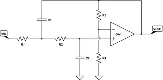

The Sallen-Key topology is the next aspect of your question. Since Sallen & Key were focused on replacing inductors with capacitors in their paper, it's no surprise that the general form is:
schematic
Clearly, in the above, it is possible to set \$R_3=0\:\Omega\$ to get a voltage follower where \$K=1\$. However, the general transfer function is:
$$\frac{V_{_\text{OUT}}}{V_{_\text{IN}}}=\frac{K\,\omega_{0}^2}{s^2+\left(\frac1{R_1\,C_2}+\frac1{R_2\,C_2}+\frac1{R_2\,C_1}-\frac{K}{R_2\,C_1}\right)s+1}$$
Here, \$K=1+\frac{R_3}{R_4}\$ and \$\omega_{_0}^2=\frac1{R_1\,R_2\,C_1\,C_2}\$.
You've specified the corner frequency at \$33\:\text{kHz}\$ and the capacitor values all at \$1\:\text{nF}\$, I think. (But I'm not entirely sure, on that last point.) You only want the resistor values. The overall gain is to be \$0\:\text{dB}\$, but the gain of each Sallen-Key stage (if you use equal valued \$R\$ and \$C\$ in its design) is then determined by its damping factor. It looks right now as though you expect all capacitor values to be the same. So I'm going to make the same assumption for the values of \$R\$ in order to keep this simple and to avoid waiting for answers from you that may not be forth-coming.
Taking the above assumptions, that all \$C\$ values are the same and that all \$R\$ values are the same, then the new transfer function is:
$$\frac{V_{_\text{OUT}}}{V_{_\text{IN}}}=\frac{K\,\omega_{_0}^2}{s^2+\left(3-K\right)\omega_{_0} s+1}$$
Here, \$3-K=2\,\zeta\$, so it follows that \$K=3-2\,\zeta\$. From this, the damping factors determined by the Butterworth polynomials then also can be understood to determine the overall gain of each Sallen-Key 2nd order stages:
$$\begin{align*}A_{V_1}&=3-1.84775906502257&&=1.15224093497743\\\\A_{V_2}&=3-0.765366864730179&&=2.23463313526982\end{align*}$$
This results in an overall gain of \$A_v=2.57483577311484\$ for both stages. Since that isn't desired, you'll need to further reduce this with a prior input stage, a stage between the two, or a 3rd stage. How you handle this is up to you and your understanding of the circumstances. So the arrangement of each stage (their ordering) is left to you to work out.

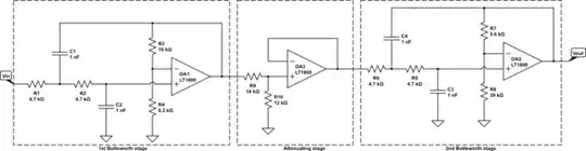

So here's a shot at it. In contrast to the discussion I had with Andy (see the discussion below his answer here), I'll select the higher-Q stage (and therefore also higher gain) to be the 1st stage. The reason for this is that you usually want the highest gain as the 1st stage for noise reasons. However, keep in mind that I've no idea what's driving this system and you may want either still more more gain, or less, in the first stage. So you may actually want a "pre-amplifier." But since we know nothing, really, let me just choose a path and follow it. Meanwhile, it's important that you keep in mind that this is just a choice and not necessarily the better choice for any given circumstance.
With that choice for the 1st stage, I'll follow it by an attenuating stage which only has the single purpose of reducing the signal sufficiently so that the final 2nd Butterworth stage can pick up from there and complete the picture.
schematic
simulate this circuit

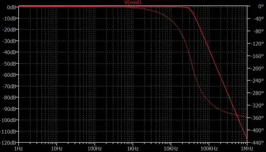

The result looks like this:
Which is as would be expected.
As I said before, it's not all that complicated.
I used standard resistor values from the E12 series.

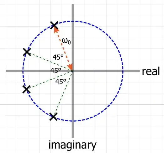

That's correct because for a BUTTERWORTH filter the product of Q1 and Q2 = 0.7071 and your product comes to 0.7065 (i.e. near enough). This then positions the conjugate pole-pairs on the circumference of a circle of radius \$\omega_0\$ (also referred to in other texts as \$\omega_n\$ and \$\omega_p \text{ note}^1\$): -
Picture stolen from Understanding Butterworth Filter poles and zeros.
If you do the trigonometry on the angles you will find that the x-axis (the real part of the complex s-plane) equals \$\omega_0\cdot \zeta\$. If poles and zeros are a bit alien to you, please read this post entitled: -
What does a bode plot represent and what is a pole and zero of bode plot?
And hopefully you'll find an explanation.

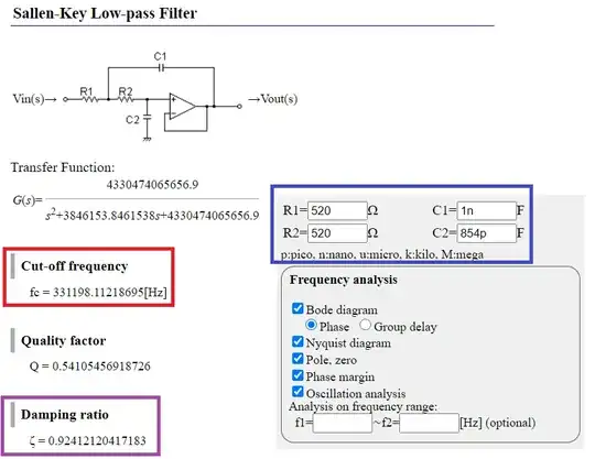

How the op-amp circuit will be ?
Does the above picture explain that adequately?
The above shows values I plugged in to get an Fc of approximately 33 kHz and \$\zeta\$ = 0.924. Step and repeat for the next stage. Always put the more highly damped first in the signal chain to prevent overshoot causing clipping AND pick your op-amps well. You'll need a GBW product well over 1 MHz.
