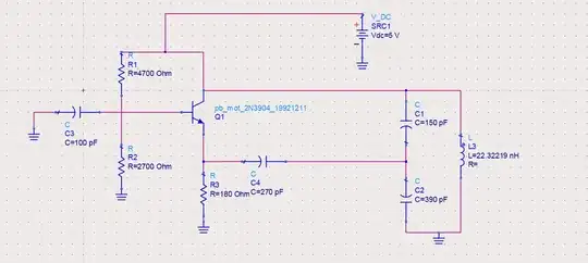

I'm a new user to ADS (Advanced System design). I'm trying to design a discrete Colpitt oscillator at 100 MHz in ADS. Here's my schematic: enter image description here
Now I wanna check if my circuit works properly. I watched and read some tutorial but it seems like a lot of new stuff to me. Can anyone help me to solve the problem?

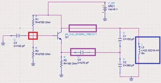

Problems in coloured boxes: -
  • \$\color{red}{RED}\$ box - no joining junction at cross over point hence transistor gets no bias
  • \$\color{blue}{BLUE}\$ box - inductor passes DC freely and hence connects collector to ground
  • \$\color{purple}{PURPLE}\$ box lower - Move C4 into vacant space in upper purple box and replace C4 with a short
  • \$\color{purple}{PURPLE}\$ box upper - Move C4 into that position
Andy aka

  • thank you! By the way, do you know how to use ADS? Which type of simulation should I use? – Henry Nguyen Jun 20 '20 at 21:49
  • Sorry I don’t know how to use it. I use micro cap 12. Did the fix proposals work? BTW if you are looking for a very good sim with tons of library parts, micro cap is now free (as in free beer and just as tasty). Highly recommended. – Andy aka Jun 20 '20 at 21:56
  • yes it helped. Actually I referenced this 100 MHz CB Colpitt Oscillator from the book Discrete oscillator design, Linear, Nonlinear, Transient and Noise Domains by Randall Rhea. Here's the schematic in the book https://drive.google.com/file/d/1N_f_R-uc-O8s287DE5zs4xJFunk1mlHi/view?usp=sharing I don't understand the meaning of CP1, port 1 and port 2. I tried to edit the circuit and made the above mistake. Have you got any idea what those things mean? – Henry Nguyen Jun 20 '20 at 22:35
  • No, I have no idea but I wouldn’t worry. – Andy aka Jun 20 '20 at 23:36
