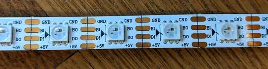

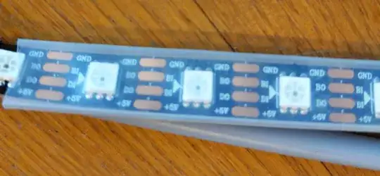

The strips are both WS2813 (at least they were advertised as such). I've attached an image of both the strips below.
Image of Black PCB
Image of White PCB

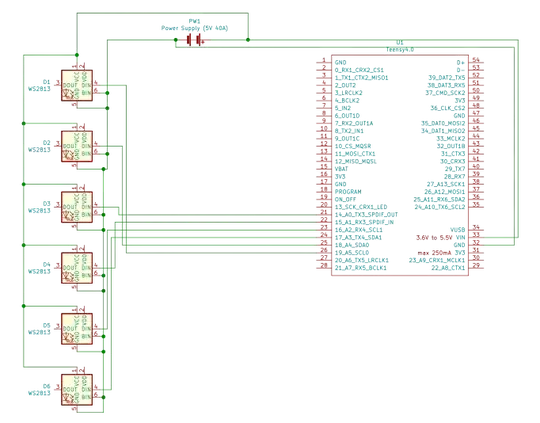

Connections
The strips are connected as follows:
Strip -- Teensy 4.0
+5V -- External 5V
D0 -- Teensy Output pin (i.e. 19)
B0 -- External GND
GND -- External GND
The Teensy is also powered by the external power supply.
The ledstrips are connected in parallel, with every strip on one of the following pins: 19, 18, 14, 15, 17 and 16.
The strips are only connected at the front, not the back.
Edit: Connecting the back to the power supply does not seem to have any effect on the shifting.
The external power supply is an RSP-200-5 (5V, 40A).

  • Do you actually mean the black PCB is a blue PCB? – Andy aka Jun 15 '20 at 10:51
  • @Andyaka, the color is black, although it might be a bit unclear in the picture because of the waterproofing. – Veleon Jun 15 '20 at 10:52

  • @Justme, I've added the voltages and a diagram. I do not know how to measure ripple and noise on the voltage, but I do have a multimeter so I'll try to find out if it is possible to measure them with it. – Veleon Jun 15 '20 at 11:40

I can see in your pictures that the two strips are not using identical parts. Note the location of the IC inside the LED package. The strip that is not working as you expect may not actually be what you think you bought. There is also the possibility of counterfeit. I suspect if you tried your setup with another strip of the white variety your issue would be resolved.
