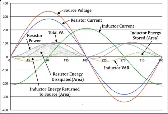

The diagram below shows the typical transfer of power from the electrical grid to a point of use. The source voltage is supplied to the user and is assumed to be an ideal single-phase AC voltage source. The load can be represented as a resistor in parallel with an inductor. The source voltage is the voltage across both components of the load.
The resistor current is in phase with the source voltage. The instantaneous resistor power waveform is the product of the resistor current multiplied by the source voltage. That minimum points on that curve lie on the X axis. The power is positive at all times, indicating that all of the power is transferred from the source to the resistor. The area under the curve represents the energy received by the resistor and dissipated as heat.
The inductor current lags the source voltage by 90 degrees. The product of the source voltage and the inductor current is a sine wave that has positive and negative values that average zero. Since that does not represent real power, is called "volt-amperes, reactive" or "VARs." There are equal areas above and below the curve indicating energy received from the source and returned to the source. That is the reactive energy.
Shown as an ideal circuit, the average and the net reactive energy transfer is zero. However there is real energy that is constantly going back and forth. In an ideal system, the reactive energy is generated when the load is connected, transfers back and forth as long as the load is connected and is given back to the source when the load is turned off. In actuality, something like 7% of the energy is lost in every transfer between the load and the generator. The utility will put some capacitor storage in local substations or even on transmission poles. Using their rate structure, the utilities encourage large users to furnish their own capacitors.
The total volt-amperes (VA) is the sum of the power (watts) and the reactive volt-amperes (VARs). That is shown as a sine wave that dips below the zero axis.
Circuit Data For Above
Supply voltage: 240 Vrms, 339.4 Vpeak
Resistor current: 200 Arms (282.8 pk)
Inductor current: 150 Arms (212.1 pk)
Supply current: 250 Arms (353.8 pk)
Power: 48 kW (96 pk-pk)
Reactive power: 36 kVAR (72 pk-pk)
Apparent power: 60 kVA (120 pk-pk)

  • Hi Charles. Based on the first paragraph before the first period, and the fourth paragraph after the second last period, did you mean that reactive energy is the energy stored in inductors and capacitors, i.e. $w(t) = 0.5 L i^2(t) + 0.5 C v^2(t)$? – alejnavab Jun 14 '20 at 00:18
  • While my questions aren't directly about power, a few things don't seem correct to me: 1) the "Inductor VAR" curve, which is the $p(t)$ of the inductor, should have a different name, because the $Q$ of the inductor is independent of time; 2) the "Total VA" curve, which is the sum of the $p(t)$ of the resistor and the inductor, should have a different name, because apparent power isn't $P+Q$ (nor $p_R(t) + p_L(t)$), it's $\sqrt{P^2+Q^2}$.) – alejnavab Jun 14 '20 at 00:18
  • 1st comment: Yes, I believe that is what I mean. 2nd comment: 1) I don't think so. 2) I intended it to be the VA or apparent power as a function of time, but I did it wrong. I will try to fix it tomorrow. I will also try to look at everything again tomorrow. –  Jun 14 '20 at 03:18
  • I double checked that and found it to be correct. Instantaneous VA as a function of phase angle is equal to W as a function of phase angle plus VA reactive as a function of phase angle. I revised my answer to show the data fro the diagram.
