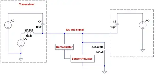

EDIT2:
Will this circuit make more sense? plc system
The sensor will also be able to couple its signal back on to the DC line, and both sides of the line should be able to send and receive data. The receiver part is not drawn in because I don't know how I would do it.

    What is the AC impedance between your "DC line" and ground? If it's too low (e.g., lots of bypass capacitors), your signal will be shorted out. – Dave Tweed Dec 04 '12 at 12:25
    In most cases an inductor will be placed between the DC source and the capacitor, to prevent the AC signal from being grounded by the low impedance of the DC source. – Wouter van Ooijen Dec 04 '12 at 13:41
    source and load impedance could be defined so you can impedance match RF at both ends and have neither loading each other. DC might be defined 0 ~10MHz RF is a~b? Coupling could be LC low Q if not overlapping spectrum or -RF transformer coupling if overlapping spectrum or directional coupler stripline if high RF. – Tony Stewart EE75 Dec 04 '12 at 16:43
  • LC low Q? Directional coupler stripline? My knowledge as a student hasn't covered those topics yet, please provide schematics or examples. Link to theory is also great – chwi Dec 04 '12 at 18:24
    You have not given enough information. What is the carrier frequency of your DPSK signal? What is the impedance of your load at carrier frequency? What have you got to prevent noise from your load being in the same band as your signal? – Jay M Dec 11 '12 at 15:00
  • I have updated my question as requested. Thank you all – chwi Dec 12 '12 at 14:59
  • Thank you for the edits, but you still have not addressed various commenters request for a description of the load. In your drawing you show an open circuit... in which case, the answer to your question as posed is YES. Just a cap is all you need. – DrFriedParts Dec 12 '12 at 22:37
  • Does my last comment help getting more sense out of the question? Thank you for all your feedback – chwi Dec 13 '12 at 09:47
  • Do you need full-duplex (talk and listen at the same time) or is half-duplex (talk or listen) enough? – DrFriedParts Dec 13 '12 at 23:06
  • I think half duplex would do – chwi Dec 14 '12 at 06:25

Yes, the standard bias-T looks something like this:
DC power source >>---L1--+                 +--L2->> "unregulated" DC power to regulator
bidirectional RF ----C1--+- mixed RF + DC -+--C2---- bidirectional RF
GND--------------------------------------------------------------------GND
where L1 and L2 are equal-size power inductors and C1 and C2 are equal-size data-coupling capacitors.
I would avoid connecting anything else to the "mixed RF + DC" line other than those two inductors and two capacitors. (Or perhaps four capacitors, if I had a separate "transmit capacitor" and a "receive capacitor" at both ends).
Since you likely have some sort of connectors between the two devices that typically have 0.1 Ohm of resistance each, coupling capacitors that give an impedance of less than 0.1 Ohm (across the entire bandwidth) will be more than adequate (and perhaps overkill).
So a capacitor with capacitance at least 1/(2*pi*90 kHz * 0.1 Ohm) =~= 18 uF is more than adequate (and perhaps overkill). You'll want a cap with low parasitic resistance (ESR), so mica, film, or ceramic -- rather than tantalum or electrolytic. You'll want a cap with low parasitic inductance, so surface-mount -- rather than through-hole.
Standard off-the-shelf capacitors and inductors are more than adequate up to 10 MHz or so. People that work with higher frequencies use striplines and resonating stubs that may appear to be black magic. Although there are a few people who claim it isn't. a b c d e
