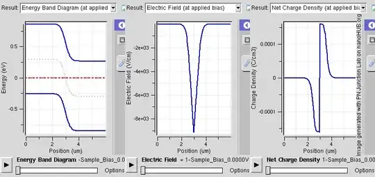

The electric field generated by the space charge that tends to counteract the diffusion at equilibrium at zero bias. The electric field collapses as it becomes more forward biased.
The diffusion zone is only a few microns, but this animations shows the Electric field gradients and animated with bias changes.
enter image description here (Image taken from Wikipedia)
With a negative bias the holes and electron move away from the junction with greater strength in the depletion zone, thus resisting current flow and visa versa. The junction also reducing capacitance with voltage. (e.g. varicap is a more precise diode voltage control capacitance, but all diodes do this)
Both polarities are non-linear.
In the reverse direction when the breakdown threshold is reached with a series resistance current flows again with more power dissipation from the VI drop.
In the forward direction once conduction takes place, the voltage increases according to the bulk series resistance or ESR.
The series resistance is not the same in both polarities due to doping and material process factors.
