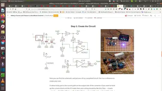

I have see this instruction about hacking one ordinary boost/buck converter by adding the current sensing to its FB pin (feedback pin) like this schematic:
and know this system using for current controlling:

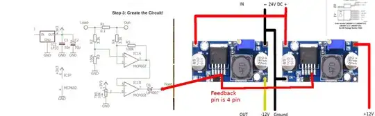

so my question is that what would happen if use the output of above current sensor as said at the two or some many LM2596 module based like this ( these Buck converter are so low cost and if could be parallel could give more current and ...) like below picture ?

    Also, unless your output dampening is excellent, it's usually a bad idea to put unsychnronized SMPS in parallel, unless their datasheet says that's possible. If you need more output current, get a larger inductor, and a switcher IC that can handle more current or one that supports an external MOSFET to handle the current. – Marcus Müller Jun 11 '20 at 13:54

  • This model of DCDC converter is NOT designed to be used in parallel. Using linear regulators in parallel can be done but you have to know what you're doing so that they equally share the load. With switched converters things are far more complex as converters deliver current pulses which means the converters can (and will) disturb each other. Experienced EEs simply don't do this and solve the issue by getting a DCDC converter rated for a higher current. – Bimpelrekkie Jun 11 '20 at 14:39
  • ...But if you want to try it anyway I wish you good luck (you need it) and if it works now that does not mean it is a reliable circuit. Suppose it works only for an hour, a week or a month? If you get a well designed DCDC converter rated for the higher current it might last years. – Bimpelrekkie Jun 11 '20 at 14:42
  • @soheilsabz I did, see my second comment from the top. Bimpelrekkie just said the same, too. So, you have your answer: you can't just put your two LM2596 in parallel. The fact that they are fake just makes it worse. – Marcus Müller Jun 11 '20 at 15:16
