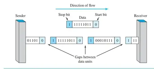

I was reading a book which says
Asynchronous transmission is so named because the timing of a signal is unimportant. Instead, information is received and translated by agreed upon patterns. To alert the receiver to the arrival of a new group, therefore, an extra bit is added to the beginning of each byte. This bit, usually a 0, is called the start bit. To let the receiver know that the byte is finished, 1 or more additional bits are appended to the end of the byte. These bits, usually 1s, are called stop bits.
As the picture below shows:
I don't quite get the idea, why do we need a start/stop bit? Isn't that a byte consists of 8 bits, so the receiver just needs to count how many bits it has received so far, if the number is 8, it has one byte and repeats the process. So why do we need start/stop bit?

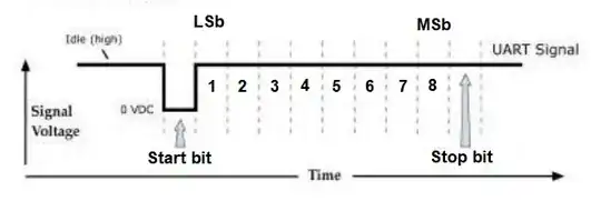

The receiver can't count the bits it's receiving, because the receiver doesn't know whether or not it's receiving bits!
Let's imagine that the sender and the receiver are communicating using sound, and let's imagine that a 0 is represented by one second of silence and a 1 is represented by one second of sound. In your book, the "idle state"—what the sender sends when it doesn't have any actual data to send—is 1, meaning sound.
Now suppose that you're the receiver, and the sender is not using a start bit. You hear eight seconds of continuous sound. Did you just hear the byte "11111111", or is the sender just idling? You have no way of knowing, because it all sounds the same to you.
Alternatively, suppose that you hear one second of silence, then six seconds of sound, then one second of silence. Did you just hear the byte "01111110"? Or was it, perhaps, the byte "11110111" followed by the byte "11101111"? Again, you have no way of knowing.
This is where the start bit comes in. Whenever the sender wants to send a byte, first it sends a 0 (one second of silence), then it sends the byte of data.
Now your job as a receiver is a lot easier! If you hear nine seconds of sound, you know that the sender is merely idling. If, on the other hand, you hear one second of silence followed by eight seconds of sound, you know that the sender just sent the byte "11111111".
Of course, most machine communication systems don't use sound; they use electricity instead. But electric signals work just like sound. The receiver is always going to receive something, regardless of whether we want it to or not. So we need to give the receiver some way of knowing whether it's receiving real data or just idle noise.

Perhaps the confusion is because we as humans when we see a diagram like in your question, we see exactly where all the bits are, which one follows which one, etc. However, imagine you are the receiver, and all you have to work with is an incoming flow of signal (for example, 2 levels, one level (say, high) to represent a 1 bit, another level (say, low) to represent a 0 bit), as analog electrical signal that is either steady or changing from one value to the other value. Again, note that the receiver is not a human who sees the 1st bit, 2nd bit, etc., with a global view.
Let's say the "idle" value is the same as the 1-bit value (high). Then you don't know when the bits start arriving unless we have the transition from the 1 to 0. Otherwise, if the first bit is 1, how do you know when it starts?
Then for stop bits, you want it to be opposite of the start bit (so, you want it to be values of 1), so it marks the end of one byte, and you can know when the next byte starts when again it goes from high to low.
