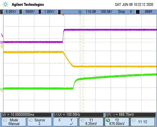

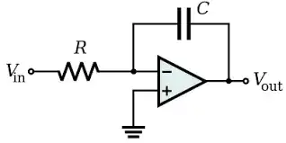

I have been using op-amp TL072C in charge integrator configuration. R = 1k Ohms and C = 100 uF. Vin is a DC signal of 1 V. VCC = 10 V and VSS = -10 V.
I get the expected output which is VSS, when a DC signal given as input. But the strange thing is that virtual ground voltage increases to about 0.65 V after output reaches VSS. Attached the screen shot. Snapshot
Why does the virtual ground voltage increases after output reaches to -VSS or saturation voltage ?
  • Probe 3: Input
  • Probe 1: Output
  • probe 2: Virtual Ground
  • Are you sure it was a TL072 op-amp? Is the question why it reaches 0.65 volts instead of 1 volt or is it about why it stops being a virtual ground? – Andy aka Jun 06 '20 at 07:24
  • It is TL072. The question is why it stops being virtual ground after output is saturated. – Naveen Sajjanar Jun 06 '20 at 07:40
An op-amp with negative feedback tries to maintain the inverting input at the same voltage as the non-inverting input by adjusting the output voltage so that the potentials are equalized. Once the op-amp output hits the end-stops, it no longer can continue to adjust the output in the correct direction to maintain a virtual earth.

  • Got it. Does it mean that if output didn't hit the rail (VSS ), virtual ground would be maintained at near 0V since non-inverting end is tied to ground ? Other question: Do you think that it should have reached 1 V instead of 0.65 V, why ? – Naveen Sajjanar Jun 06 '20 at 08:07
    Correct and it's easier to analyse in a pure op-amp amplifier circuit - just think of the op-amp as an error amplifier in a control loop - it tries to minimize the error just like any control system does (if that makes sense to you). It should reach the same voltage as the input because once the output hits a solid end stop, you can think of the capacitor as an open circuit but, maybe as Spehro said in his answer, the capacitor is a bit leaky or is an electrolytic with the wrong polarity across it. – Andy aka Jun 06 '20 at 08:09
  • Cool. I do have electrolytic capacitor there. I will flip it and check. – Naveen Sajjanar Jun 06 '20 at 08:20
  • @NaveenSajjanar You shouldn't really be using electrolytic capacitors in integrators because of this very problem. Flipping it may fix today's problem but it just means that when you input a different voltage the problem occurs again. – Andy aka Jun 06 '20 at 08:26
  • ok. I will keep that in mind. – Naveen Sajjanar Jun 06 '20 at 08:40

If you have an ideal op-amp with infinite power supplies, the integrator output voltage would integrate to minus infinity as the capacitor needs to be charged with 1mA to keep the op-amp inverting terminal at 0V.
However you have a real world op-amp with limited supply voltage. As soon as the output voltage hits the output limit, it cannot go any more negative and it will stop pulling current via the capacitor so it cannot keep the inverting input at 0V.

One would expect the voltage to increase to the input voltage, since there is no longer dv/dt to draw current from the resistor.
Since it is not, that implies either measurement error or a large leakage current through the capacitor (maybe an electrolytic capacitor with the wrong polarity).

If the output Voltage reached the vss. The capacitor C is nearly cut off. So the feedback branch / C doesn't work. The invert input voltage can be What you input. It is no longer VIRTUAL Grounded. Caution, too high voltage may destroy the op amplifier. For more details, See the Data sheet of the op Amplifier.
  • Can you explain what "the capacitor C is nearly cut off" means? – Circuit fantasist Jun 07 '20 at 09:54
  • As time went by, The capacitor C was gradually charged fully, So there's no current flow through the Capacitor. Actually, The feedback loop of op amplifier was open then. So the virtual grounding doesn't stand anymore. – Wingman Leee Jun 08 '20 at 03:55

The virtual ground is generated by the gain of the feedback loop. If the output of the amplifier saturates, it can't provide any gain and thus the virtual ground collapses.
If no gain is present, then leakage currents will define the voltages. The leakage current might even come from parasitic devices which are not shown in the schematic.
My explanation of rising to 0.65V and then to 1V: The fact that it reaches 0.65 very fast, indicates that a diode starts to clamp it. The JFETs use pn junctions to modulate the cross section of a resistive channel and therefore pn junctions are present between the gate and the source/drain. The current flowing into the non-inverting terminal is due to such reverse bias current of the pn junction. This current flows downwards and increases the voltage at the drain of the input JFET very fast in the beginning, because the bottom current mirror is deactivated. As soon as this voltage approaches the threshold voltage of the mirror's beta helper transistor (0.6-0.7V), the helper starts to conduct current and the base voltage of the mirror starts to raise. As a consequence the mirror will conduct current and swallows the leakage current of the input JFETs gate-drain junction. It is a negative feedback and it will stabilize itself, what the oscilloscope has shown us as well.
