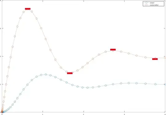

So I used again the example system
$$ G(s) = \frac{1}{s+2}$$
and the control
$$u(t) = 10\int^t_0(r(z)-y(z))dz$$
which resulted in the following step response. Notice that at all those red boxes we have \$e(t)=0\$, and they are the inflection point of \$u(t)\$, but none of them are the steady-state (when y(t)=r(t) and stays so for any future time). And that should point that your remark about "[u(t)] is still there and larger than 0, while the P-action and D-action both are zero and have no effect anymore." is only correct at the steady-state, because at most points where \$e(t)=0\$ the P-action will be zero, but not the derivative one.
step response with markings pointing at the inflection times of the control effort
Is it that the error gets smaller once e(T)=r(T)−y(T)<0 and the integral gets smaller?
First it would be better to say the "integral gets closer to the steady-state control", since it doesn't always means getting smaller. There will be situations where the error will not decrease after the inflection point, specially if there are delays. But for the system that I used as an example it does so.
