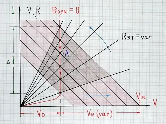

The "problem" of an LED (and each diode) is that it has not constant (static, ohmic) but "dynamic" resistance that decreases when the voltage applied to the diode increases. Thus, in Ohm's law, both voltage and resistance change but in opposite directions - I = Vinc/Rdec. As a result, the current through the diode vigorously increases... and if the applied voltage is quite higher (9 V here) than the diode threshold voltage (typically 2 V for an LED), the current and accordingly the power, will become unacceptably high. To solve the problem, we connect a resistor in series. The operation of this network is visualized in Fig. 1.
LED as dynamic resistor
Fig. 1. LED presented as a voltage-stabilizing dynamic resistor
When we turn on the power supply, the (input) voltage VIN increases from zero to maximum. In the graphical representation, its IV curve (including the resistance R) moves to the right (translates). At the same time, the diode begins decreasing its static resistane RST so its IV curve rotates counterclockwise. As a result, the operating point A slides up along the vertical part of the diode IV curve. The current variations are significant while the voltage drop VD (VF) across diode does not change - the diode differential resistance is zero.
The incandescent lamp also does not possess constant resistance. However, in contrast to an LED, its dynamic resistance increases when the voltage applied across the lamp increases. Now, in Ohm's law, both voltage and resistance change but in the same direction - I = Vinc/Rinc. As a result, the current and accordingly the power, more slowly increase... and will not become unacceptably high.
Circuit fantasist
  • 16,664
  • 19
  • 61
    This should be the top answer. The LED will drop only so much voltage, leaving the wiring to drop the rest. Since the resistance of the wiring is well under an ohm, to drop the voltage requires a current that is much more than enough to destroy the LED. (I once made an LED explode with a loud BANG by overloading it...) – EvilSnack May 29 '20 at 07:07
  • Thanks... Interesting thoughts showing a tendency to think deeply... The conclusion is that we have to absorb the redundant voltage by some "elastic" element (resistor)... or by a combination of elements where some of them are "stiff (diodes)... but at least one of them is "elastic". – Circuit fantasist May 29 '20 at 09:17
  • You lost me in the last sentence. "in Ohm's law, both voltage and resistance change but in the same direction". 1) In Ohm's law the resistance does *not* change; it is a constant (independent of the voltage) 2) If you meant current as a function of voltage, that is also the case for both the LED and bulb - both have a positive, but non-linear, resistance (otherwise it would a negative resistance (possible with active circuits)). The second derivative (derivative of resistance) is zero for Ohm's law, negative for the LED, and positive for the bulb. – Peter Mortensen May 29 '20 at 18:23
  • @Peter Mortensen, interesting thoughts... I just wanted to explain the "dynamizing trick" where we change the voltage but, in the same time, someone changes the resistance. As a result, depending on the change direction, the current magnitude is increased (if the resistance was decreased) or decreased (if the resistance was increased). If we go too far with this trick, we will observe negative resistance - S-shaped in the first case (neon lamp) and N-shaped in the second case (tunnel diode). – Circuit fantasist May 30 '20 at 08:11
  • @Peter Mortensen, I have illustrated the idea behind the voltage-stabilizing dynamic resistance in my answer above. It is based on the believe that basically, the diode is a kind of "resistor" but non-linear... and this non-linear resistor can be thought as of a dynamic (self varying) static resistor... – Circuit fantasist May 31 '20 at 18:31

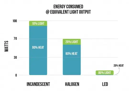

A light-bulb is pure resistance - it passes a current and it gets hot and it gets so hot that it glows and produces light. It is inherently an inefficient method of converting electricity into light. It has a voltage and power rating and therefore you apply the correct voltage and you get a power consumption of 10 watts, 20 watts, 40 watts etc.. and a lot of heat.
An LED also produces light and it produces light with maybe up to five or ten times more power efficiency than a regular light-bulb - that is one of its biggest attractions.
Graph from here.
Why does an LED need some resistance and a light bulb does not?
The downside is that an LED comes with restrictions of supply voltage and that means being careful when you apply voltage to it. Of course an LED could come with a built in resistor that allowed it to be used on the same voltage supply as a light-bulb but that misses the point of using an LED to produce light power efficiently.
So, if you don't need a highly efficient light source use an LED with a series resistor. If you are relying on the power efficiency of an LED (because you need to) then drive it carefully, effectively and efficiently.
