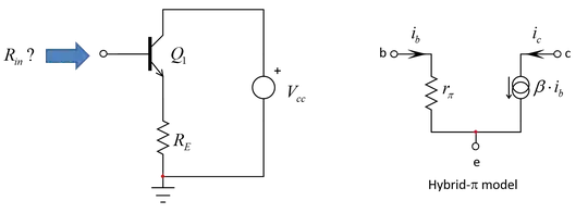

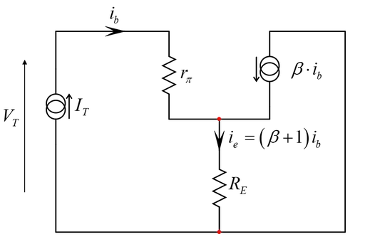

To determine the input resistance of a simple common-collector configuration you have to replace the transistor symbol by its equivalent hybrid-\$\pi\$ model. The common-collector configuration is shown below and the transistor simplified linear model is in the right-side of the picture:
Then, to determine an input impedance or resistance, you install a current source \$I_T\$ (the stimulus) biasing the terminals across which you want the resistance and you express the voltage \$V_T\$ (the response) that it generates. Then, you simply write \$R_{in}=\frac{V_T}{I_T}\$. Here we go with the drawing:
This is a small-signal model in which we consider the \$V_{cc}\$ rail perfectly decoupled meaning that any modulation applied to the circuit won't make the voltage of this rail move. In other words, its differentiation with respect to time is 0, hence the replacement of the source by a wire. To determine the voltage \$V_T\$, we stack the voltage across \$r_\pi\$ with that across the emitter resistance \$R_E\$. In this drawing, the base current is actually the injected current \$I_T\$. Therefore, \$V_T=i_br_\pi+(\beta i_b +i_b)R_E=i_b(r_\pi+(\beta+1)R_E)=I_T(r_\pi+(\beta+1)R_E)\$.
Now, divide \$V_T\$ by \$I_T\$ and you have \$R_{in}=r_\pi+(\beta+1)R_E\$.

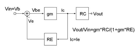

Here comes my (very short) answer:
From system theory we know that the input impedance of a circuit with feedback (if the feedback signal is a voltage) will be enlarged by the factor (1-loop gain). The same expression appears in the closed loop gain where it appears in the denominator (the gain is reduced by this factor).
As it is shown in the figure below, the gain around the feedback loop (loop gain) is LG=-gm * RE.
Hence, Zi=hie * (1+ gm * RE) with gm=hfe/hie, we arrive at
Zi=hie + hfe * Re.
(In this formula, we have hfe instead of (1+hfe) because I have assumed, for simplicity, Ie=Ic. The difference between hfe and (1+hfe) can be neglected).
Remark: I know that - primarily - you are interested in a derivation of that formula from the Pi-model. However, for my opinion, it is always interesting to get a confirmation based on a complete other approach - for example from the viewpoint of system theory.
UPDATE/EDIT: I do not like and I do not need transistor models. Instead, it is very simple to derive the formula for the input resistance using basic formulas:
h11=vbe/ib=vb/ib-ve/ib.
With ve=RE * ie =RE(1+h21)ib we immediately arrive at
ri=vb/ib=h11+ve/ib=h11+RE(1+h21)
