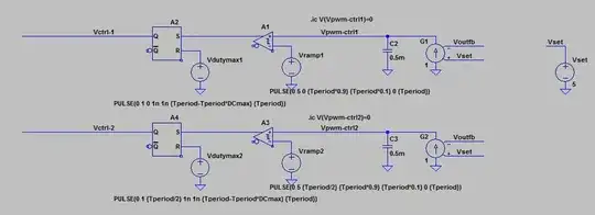

I am modeling a Push-Pull Converter in LTSpice and implemented this for a simple voltage feedback PWM control. This works great and I have added a bit on the end that allows for a maximum duty cycle control, as shown:LTSpice control section
What I'm noticing is that when the duty cycle gets set to something low by the feedback control - under 10% - it starts to drive the two switches unequally during periods, e.g. one will be on for 40% and the other on for 7%. I tried putting another voltage source set to 10% pulses connected to each control line via a diode, but LTSpice did not like that.
Is there a better way to implement both maximum and minimum duty cycle control?
Alternatively, if someone can tell me why the switches are being driven unequally that would also be helpful.

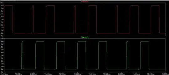

EDIT: I've included a screen grab of exactly what I'm talking about:Unbalanced example
Sometimes the feedback will drive one switch for 40% and the other for ~7% in the same period and that is not acceptable. I am looking for a way to have the control say "this period the duty cycle will be 10%" for example, and force BOTH switch driving signals to be that duty cycle for the whole period. I have been trying something with the feedback signal as a reset for an SRFlop and "carving out" the off-time, but it's not working correctly.

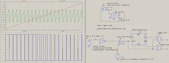

For a push-pull configuration, this would take care of both the minimum and maximum allowed levels from the error amplifier (V(in)), and the distribution of pulses for the switches:
pp
The dflop must have a delay, otherwise the solver will abort with errors (because of the direct feedback). Other delays or taus are also for aid in convergence. A7 is the OTA, as proposed above, but with the linear flag, to avoid unnecessary nonlinearities due to the tanh() limiting. All the vhigh greater than 1 are just for easier viewing when plotting. Note that T is 5 μs for a 100 kHz switching frequency.
As a bonus, A2+C1+G1 form a ramp generator with sync pulses. These will be a bit wonky (they go to -95 V here), but in terms of logic, the gates receving this signal only care about ref, or vt+vh. V(saw) can replace V(ramp), but the frequency may need tweaking. 0.97 seems a better fit for 100 kHz, but it varies, and I suspect the timestep to be of a major influence, as well as tau and internal parasitics.

  • Complementary outputs won't work for this application. I've edited my original post to be more clear. – pbandjazz May 27 '20 at 00:51
  • @pbandjazz I've updated my answer. – a concerned citizen May 27 '20 at 08:05
    Exactly what I was looking for, hopefully I can pick it apart to truly understand what is going on. For anyone needing this and wants a higher drive output like I did, editing A5 and A6 with "Ref=0.5 Vhigh=10" or whatever your desired output drive is works. – pbandjazz May 31 '20 at 21:09
