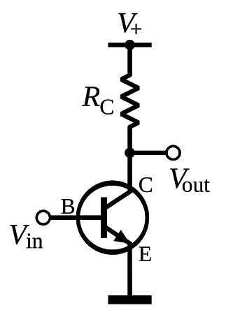

If we increase the collector resistance then how will the collector current change? I understand the circuit behavior if i neglect early effect but when i try to include it that is allow Ic to vary with Vce i get lost because everything changes and it's as if i lose the grip on all variables.

To a first approximation, the transistor is a current source, so changing the collector resistor does not change the current, only the collector voltage
We can model the transistor as either a base current controlled current source (hFE, beta), or a base voltage controlled current source (gm). Which model is most convenient depends on whether we're biassing the transistor, or using it as a small signal amplifier.
To a higher order approximation, the collector current will change slightly with the collector voltage. You've already mentioned the Early effect, so you understand that.
For very high values of Rc, where V+/Rc exceeds the current the transistor is trying to sink, the transistor will be saturated, and neither collector voltage nor current will change.

  • A reduction in Rc leads to a reduction of the voltage across Rc and then will cause a rise in VCE, now this rise in VCE causes ice to increase due to early effect,then this larger IC current leads to a larger drop via the resistor and hence decreases VCE,which then leads to a decrease in ICE . Now this decreased IC leads to a lesser drop via the resistor hence increasing VCE, Which then lead to an increase in ICE.... And we get stuck in an infinite loop. – Kashmiri May 26 '20 at 04:37
    @YasirSadiq If you try to solve it strepwise like that, yes, it's an infinite series (not an infinite loop), but like the infinite series 1 + 1/2 + 1/4 + 1/8 ... it sums to a finite result. It's far easier to write down the implicit equation, and then solve it, that's what modelling the effect as an extra resistor on the collector is for. In hybrid parameters, it hoe, the 'output impedance'. – Neil_UK May 26 '20 at 05:13
  • It won't be an infinite loop but an infinite sequence, this was very very helpful for me, Thank you. I would request you if you could explain your next part of modeling as a resistor. Say i change the Rc to 2Rc,and all sources are DC now how would our modeling help here. All i can think is that we've got to use the large signal model and solve those difficult equations as LvW pointed out that it's hard to use math in some cases for exact solutions. – Kashmiri May 26 '20 at 10:46
  • It is solved with Vcc to Rc, and the BJT represented by a current sink from the collector, and by hoe from collector to emitter. The best way to solve this is superposition, solve for voltage and current sources independently, then add the two solutions together. Do the same after replacing Rc with 2Rc. Treating a transistor as a current sink in parallel with hoe is a model, that simplifies its behavior. You can have more complex models, or you can measure a transistor. We tend to use the simplest model that meets our needs. If yours are not met by hybrid parameters, then go more sophisticated – Neil_UK May 26 '20 at 13:08
