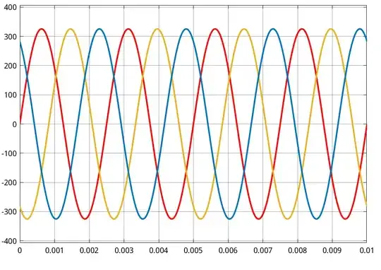

Both start off with a sinusoidal phase demand reference (either due to the output of an inverse Clarke-Park transform or via some other source) enter image description here

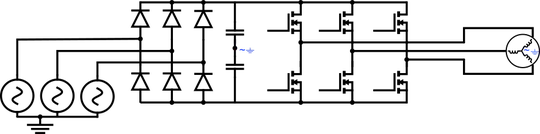

So how is SVPWM different? Well because it works on the 3-phase vectors as a whole and tries to synthesis all at once (rather than independently), the resultant voltage waveforms are different. How these are generated (the exact timing, the resultant line-line, the mathematical equations) are an implementation specific point but the result are voltage demands seen below. These are directly compared with the triangle wave carrier to create the needed PWM

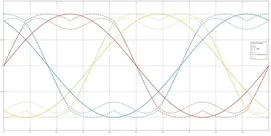

--edit-- Adding visual overlay of the reference voltage waveforms for
  1. Sinusoidal
  2. SV-PWM
  3. 3rd harmonic injection

    @AhmedEshra I have just added a plot for the three main methods (spwm,svpwm,3rd-harmonic) so you can see the difference. As I said 3rd is an old scheme now but was simple to create in analogue. The blog you posted is SVPWM and captures the sectors. I can't comment on most but if they are anything like blog posts on FOC ... then they could be wrong. The key with svpwm is once you determine what sector you are in and what voltage you want, you cycle through the four valid pwm states to create the desired vector length. –  May 23 '20 at 23:00
