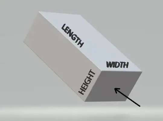

Imagine a block of material with a uniform density to it. Something like this:
The material also has, let's say, a uniform "resistivity" to it.
Now, suppose we cover the entire face pointed at by the arrow, and the face opposite to it that we cannot see, by plating them with silver (which is very conductive.) We then measure the resistance between these two silvered faces on opposite ends using an ohmmeter. There will be some value for that in Ohms.
Now, let's consider three modifications:
  1. Suppose we doubled the length. Here, since the silvered faces touched by the ohmmeter have the same area as before, but are further apart, we should expect that the resistance we'd measure between the opposite X faces would double.
  2. Suppose we doubled the height. Here, since the silvered faces touched by the ohmmeter have doubled in area but are the same distance apart as before, we should expect that the resistance we'd measure between the opposite X faces would be cut in half.
  3. Suppose we doubled the width. Here, since the silvered faces touched by the ohmmeter have doubled in area and are the same distance apart as before, we should again expect that the resistance we'd measure between the opposite X faces would be cut in half.
So, we postulate the following about the resistance we'd measure:
  • \$R\propto \text{Length}\$
  • \$R\propto \frac1{\text{Width}}\$
  • \$R\propto \frac1{\text{Height}}\$
  • \$\therefore R\propto \frac{\text{Length}}{\text{Width}\:\cdot\:\text{Height}}\$
Now, if we call the length, \$L\$, the width, \$W\$, and the height, \$H\$, and introduce a constant of proportionality, we can say:
$$R=\rho \cdot \frac{L}{W\cdot H}$$
Let's now express the above only looking at the SI dimensions:
$$\begin{align*}\Omega=\rho \cdot \frac{\text{m}}{\text{m}^2}, &&\therefore \rho=\Omega\cdot\frac{\text{m}^2}{\text{m}}=\Omega\cdot\text{m}\end{align*}$$
Just simple dimensional analysis.

  • What is the principle that allows us to halve the resistance if we double the terminal area? – elile May 21 '20 at 04:50
    @elile Twice the conductance. Two equally conductive paths driven by the same EMF (volts per meter) will have twice the conductance of just one of them, separately. The resistance is therefore half as much. (That is, without introducing other problems. It's always possible to hypothesize edge-case scenarios which may complicate such questions. But these are very rarely encountered in practice. Usually, they only happen when scientists intentionally create those circumstances to see what then happens.) – jonk May 21 '20 at 08:38
