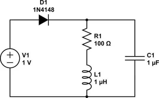

A reverse current ultimately manifests as current flowing the wrong way through the power input terminals. But there is a difference between whether this is being caused by the voltage at the inputs being applied in reverse or whether the load itself is trying to push power back towards the supply.
The diode D1 will block any currents from flow through it in reverse whenever the potential at the cathode is more positive than the potential at the anode. This occurs both when V1 is reversed or if the voltage across the load gets higher than V1 and the load tries to push power back towards the supply. Conversely, the diode will conduct whenever the potential at the anode is more positive than that at the cathode.

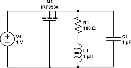

But something like a PMOS wired as an "ideal diode" doesn't actually behave completely like a diode. The PMOS blocks current whenever the gate voltage becomes more positive than the source voltage. This occurs when V2 is connected in reverse.
Conversely, the PMOS conducts whenever the gate voltage is more negative than the source terminal voltage. This occurs if V1 is connected with the correct polarity (kickstarted by the PMOS body diode) BUT it also occurs whenever if the load develops a voltage that is higher than V1. This means that the PMOS does not prevent the load from pushing power back towards the supply. This can occur when motors are backdriven and behave like generators, or when the supply brownsout and the load bypass capacitors dump energy back into the supply. More complicated PMOS circuits are required in order to prevent this from happening.

Therefore some circuits will block reverse currents due to reversed input polarity at the input terminals and when the load voltage exceeds the supply voltage, but others will only block reverse currents due to reversed input polarity.
