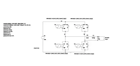

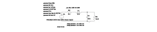

I'm trying to create a filter that filters the output of an inverter at 50kHz PWM (from reading the comments, I'm not sure if I should be calling this the switching freq?) to a sinusoidal one at 50Hz with a THD of less than 2% for the output voltage waveform (output voltage should be at 230Vrms). This circuit is supposed to model an inverted DC-AC output, with a filter attached to this output.
The schematics provided should model the inverter with an output of 50kHz PWM, although from reading the comments, I'm not sure if the voltage source allows this simulation?
I'm experimenting with a simple LCR one stage filter if possible. I understand that a low pass filter requires the shunt capacitor to short the high frequencies, but I'm not sure why the design recommended the use of a series inductor. In the schematics provided, R2 can be viewed as the parasitic resistance of the circuit, and R1 is the load resistor. I'm not sure how to calculate for the L and C values to be used to obtain the specified THD value.

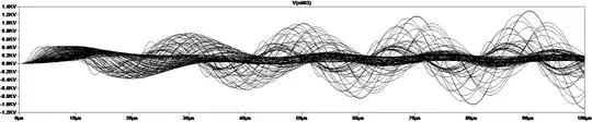

I've tried running through a range of values, but I'm not sure which combination of L and C I should be using. The output waveform (a little messy because of the number of simulations I ran.)
The ideal values for L and C might not be in the range provided. Please advise.
Edit: enter image description here
I've included the inverter circuit so that I can output a PWM waveform. I've modelled the switches to turn ON and OFF to output a triangular wave

  • Okay, I've edited the question, apologies for any confusion. Hope that clears the question. The voltage source here is supposed to model the output of the inverter at 50kHz, and from this waveform, I'll like to obtain a sinusoidal 50Hz waveform with at most 2% THD. Would this be feasible? – cpure May 17 '20 at 16:09

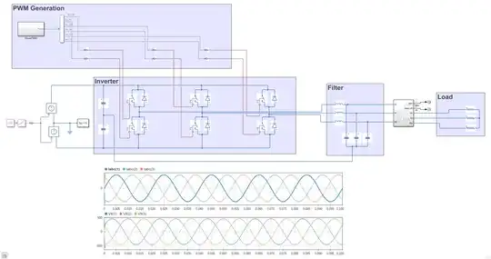

Model the inverter
In the OP a simple 50kHz pulse was used into an RLC "filter". This however isn't how an inverter would work to generate a fundamental of 50Hz (with a PWM of 50kHz).

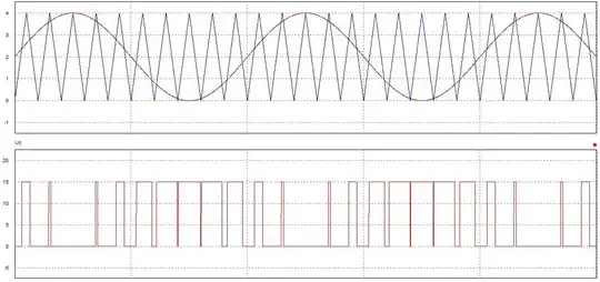

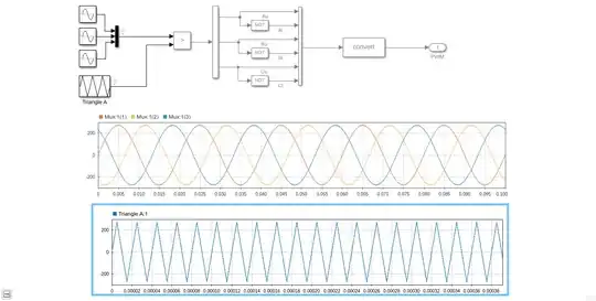

What is needed is a 50Hz sinus waveform is modulated via a 50kHz carrier.
There are a number of way to perform this. The classic method is via generating the desired 50Hz waveform and using a comparator, compare this with a 50kHz triangular carrier to generate the desired modulation pattern in real time.
Another option is to pre-calculate the PWM patterns and store in a lookup table. Such a solution is very convenient for fixed-frequency, cheap inverters
With the PWM generation created, the inverter and a simple resistive load can be shown. A resistive load is prefered in such examples because an inductive load will smooth out the currents
nice switched voltage and current, but you can see an underlying harmonic. NOTE: an inductive load would have smoothed the currents but the voltage would still look chopped
Design the filter There are a number of methods associated with this. Typically they work by setting the resonant frequency of the filter at the logarithmic halfway be the fundamental and the switching. In this instance, around 1.5kHz
How you balance the L-C is based upon your design criteria. Working through one such method
L = 672uH
C = 16uF
targeting 15kW (10R per phase)
Model the system
With the pwm inverter model running and aspects of the output filter designed. They can be connected to confirm functionality
LTspice.
To generate suitable pwm patterns, two voltage sources (pulse and sine) to create teh triangle carrier and the modulated signal are needed. A schmitt comparator can be used to generate the PWM signals to then feed to the inverter
  • Thanks, that cleared a lot. I've remodelled an inverter with the suggested filter (i'll change this after to fit my load specification), but I'm not sure if my PWM is working, the waveform this schematic outputs doesn't look right. I've tried for a triangular carrier at 50kHz, but I dont have a 50Hz sinusoidal to superimpose on it, as my source is supposed to be a DC source. I'll edit my question to post my schematics – cpure May 18 '20 at 06:43
  • You are sending the triangle wave to the inverters. You need to generate the PWM 1st –  May 18 '20 at 10:35
