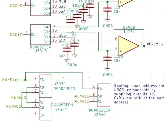

I'm multiplexing a 4 channel 16 -bit DAC to 21 output channels via DG4052 multiplexers (exact part numbers and links to the datasheets below). There's a 10nF hold capacitor after the multiplexer, with the output going to the + -input of a TL074 opamp.
The relevant part of the multiplexer schematic:
MUX schematic

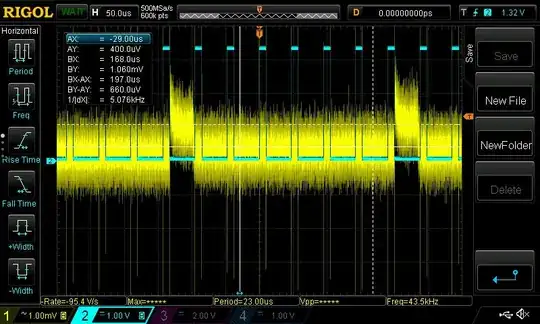

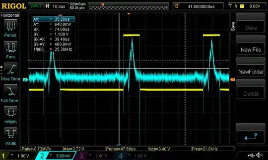

The problem: The output of a channel, take for example VExpMCU, glitches by about 1.2mV when the enable toggles, and the address of the corresponding channel is selected. In the picture, the yellow trace is VExpMcu, AC coupled, and the blue trace is the MUX enable (which is inverting). The output value is held constant, so the ideal result would be a flat horizontal line:
Glitch

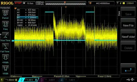

As a test, I added a 270\$\Omega\$ resistor between the DAC1 output and the MUX input. The result was that the glitch level about halved, but the initial transient is still about the same as before. Note the different time scale, and also the cursors showing that the step is now smaller, at about 660\$\mathrm{\mu V}\$:
GlitchWith270ohms
Interestingly, increasing the resistor to \$1\mathrm{k\Omega}\$ (sorry about the really bad picture here, vertical scale is 1mV/div) about further halved the step, but the initial glitch size remains about the same, with a much longer settling time. This suggests it may nonetheless be something similar to what Andy aka suggested, but there's still a downward step when the enable turns off, which means that somehow the hold cap immediately loses some charge:
GlitchWith1kOhm

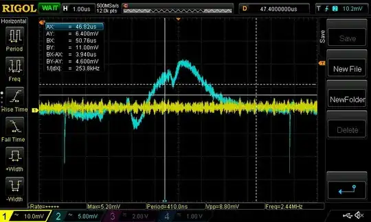

NEW on May 18th: Setting all the channels to the same output value (so the DAC output would ideally be constant, and it's easy to scope slight glitches there) gives the following scope shot, yellow is enable (active low), blue is directly the DAC output:
DacOut

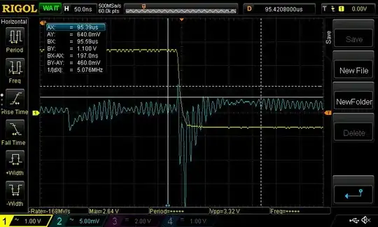

The big glitch happens while enable is off, so it's irrelevant here. However, there seems to be something on the rising/falling edges. Zooming in on the glitches near the enable signal edges:
DacOutZoomR DacOutZoomL

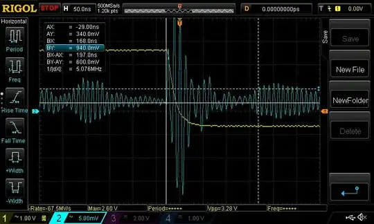

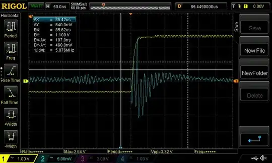

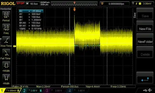

Then a scope shot of the power supply, yellow is still enable, blue is now the 3.3V analog power (AC coupled) measured at C1407:
SupplyGlitch
which seems to tell us everything: the analog supply sags when the enable toggles, causing the DAC output to glitch, which causes the glitch in the mux output. However, one more scope shot throws a wrench in the works: triggering the scope from the DAC output glitch (the big one that happens while the enable is off) gives the following (Blue is DAC output, yellow is 3.3V analog at C1407):
Supply and DAC output
Note the absence of the supply glitch. Basically, the scope shots of the 3.3V line are inconsistent, so one of them is wrong. So now I'm thoroughly confused.
So how do I check if the problem in the supply is real or a scope artifact? If it's real, how to fix it? There's over 50\$\mathrm{\mu F}\$ of capacitors on the power rail, so just throwing more won't help unless it's a lot more. Here's the power section of the board, in case that tells us something (EDIT: regulator has since been swapped):

As before, when triggering on the DAC the glitch on the supply line is not present, so that mystery still persists. It's also not on any other power rail when triggering from the DAC. However, it's there on all of them when triggering from the enable signal, for example this time with the yellow trace being +12V at the input to the analog 3.3V regulator:
Glitch12V
This is making me think that the glitch on the power rail may be an artifact of my scope grounding, somehow leaking from the neighbouring channel when I'm triggering on the enable (I also tried to use channels 1 and 4 on the scope, just in case, no difference). However, it's always there on the DAC output, so that's probably real.
So what now?

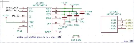

  • Do you have a local load at the output of the DAC buffers? The minimum is 2k - I would try putting something like a 10k resistor to ground directly at the output of the DAC if you don't already have something.The output impedance of the DAC is 0.1 ohm and it may need some sink current. – Peter Smith May 15 '20 at 11:15
  • @PeterSmith Added a schematic of the DAC output section. Hmm, interesting: I interpreted the 2$\mathrm{k\Omega}$ as the smallest allowed resistor size (i.e. minimum value for the effective load resistor), and just thought that the huge resistance provided by the TL074 input would suffice. – Timo May 15 '20 at 11:23

  • @PeterSmith the datasheet on page 18 shows a "Typical operating circuit" where the output goes directly to the + input of an opamp buffer, so it isn't clear that a load is needed. – Timo May 15 '20 at 11:37
  • Agreed, but datasheets are sometimes a bit incomplete. – Peter Smith May 15 '20 at 11:53

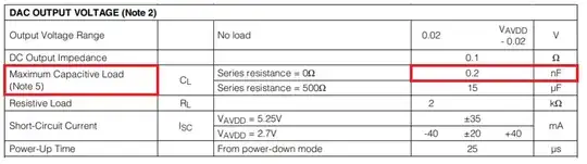

There's also the problem of maximum capacitive load as specified in the data sheet: -
With 10 nF connected the internal DAC buffer amp may actually be going a little unstable with 10 nF connected.

  • The instability might be a good point. I did notice that when designing the circuit, however, with a 500$\Omega$ resistor the buffer should be stable up to 15 $\mu$F. Now, the DG4052 has about 85 ohms on-resistance, but of course it's not clear how much that helps. – Timo May 13 '20 at 11:40
