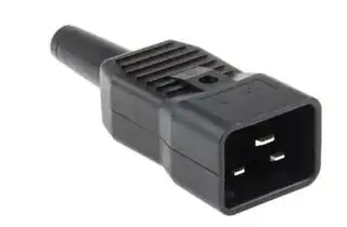

It's because the plug contacts know nothing about the voltage of the circuit. All the contacts know about is the current through them and the contact resistance. The voltage on the load is irrelevant as far as the contacts are concerned.
Figure 1. A Schurter C20, 16 A plug. Image source: RS Online.
I couldn't find a specification for a 13 A plug but the C20 plug has a contact resistance of < 10 mΩ according to RS. At 16 A the power (heat) dissipated in each of the live and neutral pins would be given by \$ P = I^2R = 16^2 \times 0.01 = 2.56 \ \text W \$ or 5 W for the feed and return. This is not insignificant.
Note that the voltage across the load doesn't enter into the calculations. Current is what matters.

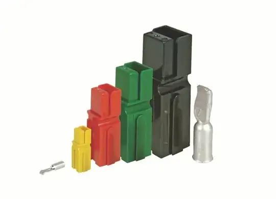

Figure 2. Something like Anderson Power Products Powerpole connector series may be more suitable.

  • Thank you for the explanation and advice, Anderson Powerpole are well suited for the voltage and current I'd be using. However I'm looking for a wall socket. Could you recommend a wall socket capable of such high currents? Thanks again! – m93a May 11 '20 at 19:12
