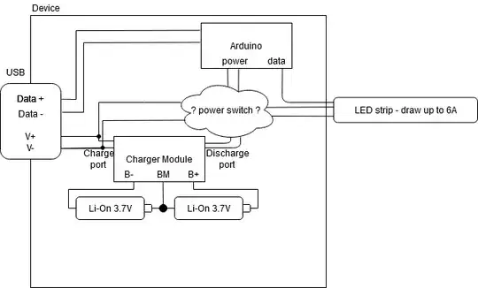

I'm working on project which is supposed to be user friendly. It will usually run on battery and highest expected current draw is around 6A, but usually around 2A. I will probably use Li-On battery, perhaps 2 in series with equalizing and charging protection module.
I want to connect it via USB to PC for data transfer AND charging, or just power bank, or adapter only for charging.
As I am more programmer, than electrical engineer so I'm unable solve this problem. I need some sort of "power switch" which would be able to detect power from USB to charge battery and cut off battery output not to feed power back to USB and charger.
I thought about connecting the LED strip directly to discharge port - that would eliminate one branch of this problem. But there still remains the problem of switching Arduino power from battery to USB.
I found Adafruit charger which seems to solve this problem, however its rated only up to 1A. So I need that, but for up to 6A.
When searching around the internet I came across MOSFET in P channel configuration. If I understand them well they should basicaly "switch off" when they get voltage on Gate.
If this is a good way to think could you please help me how should I connect it all up?
If it's not the right way please point me in better direction.
