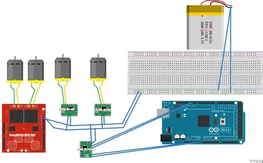

I have build a solution that looks almost like this: enter image description here The wires that does the communication between the Micro Maestro and the two Jrk's and the RoboClaw are not included, so this is not a perfect drawing but maybe you get an impression on how this looks.
I power my Micro maestro from the battery, and then power my Arduino mega from the Micro Maestro (5V) and also my Jrk's are powered from my micro maestro (this is not shown in the image).
The communication is done by sending commands from Arduino using serial communication (pin 10 and 11 on the Arduino) with the micro maestro and the micro maestro sends commands to the 3 motor controllers (jrk's and RoboClaw). This works ok for some minutes.

The reason I left a comment about a schematic is because the diagram you posted is not clear about what pins are being used on the motor drivers and microcontroller, etc. As-is, it requires anyone reviewing it to go look up the pinouts of the various parts. It's better to show the distinct, relevant connections and leave out all of unused bits. For example, how am I supposed to know exactly how you connected the JRK controllers to the motors?

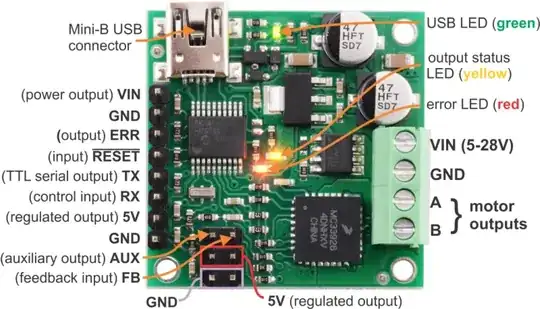

Here's the Pololu diagram for the JRK 21v3 USB Motor Controller. (Is this even the one you're using? They make a lot of them.)
Pololu JRK 21v3 USB Motor Controller Wiring Diagram
Your diagram makes it look as though the motors are on different pins of the header rather than the screw terminals labeled "A/B motor outputs."
Original "wiring diagram"
