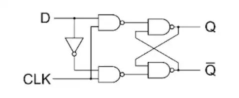

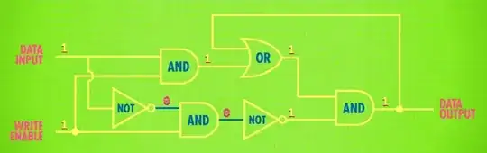

If the purpose of this circuit is to store the value of D in Q, why should I need a !Q? Why don't use a circuit like this instead?:
  • The first diagram is a flipflop. The second one isn't. It's a latch. You can see in the diagram for the flipflop why you need !Q. It's output feeds back into the circuit. – scorpdaddy May 05 '20 at 14:17
    @scorpdaddy: The first circuit is a latch, too. – Dave Tweed May 05 '20 at 14:18
Advantages of the first circuit over the second:
  • 5 gates instead of 6.
  • two gate types (1- and 2-input NAND) instead of three.
  • gates that invert (NAND, NOR) are inherently simpler and faster than gates that don't (AND, OR).1
  • only 2 or 3 levels of gate delay between input and output instead of 3 or 4.
As you can see, there's no disadvantage associated with having the !Q output even if you don't use it.

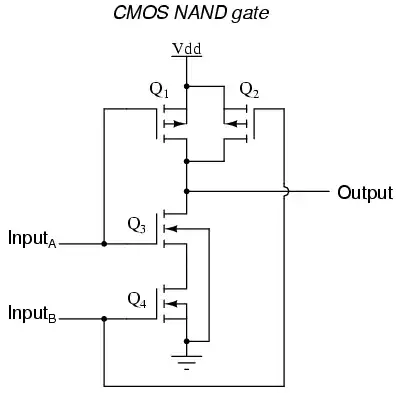

  • That NAND and NOR gates are simpler and faster than AND and OR I really didn't know. I think that this is the answer I was looking for. I thought that NAND and NOR gates were both made from AND and OR, but this comes from a Computer Science perspective, not Electrical Engineering, which is the real practice. Thanks man! –  May 05 '20 at 14:41
  • I added a link to a question that explores the details of that. – Dave Tweed May 05 '20 at 14:45
-1
Logic gates are internally structured in mosfets or transistors, both the OR and AND gates use more mosfets than a NAND gate, as such it ends up as a simpler circuit at that level,
I recommend you follow the image source link as it draws out the internals of the logic gates for you.
Image link and a good resource
