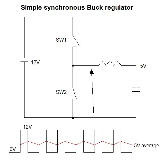

If you simulate a synchronous buck converter then the two switches (yes, there are two in a synchronous buck converter) are wired like this: -
Picture above from here.
If SW1 is on then SW2 is off and vice versa. This means that the average output voltage is the input supply voltage (12 volts in the example above) * duty cycle. In the picture above the duty cycle (as a fraction) is: -
$$\dfrac{5}{12} = 41.667 \text{ %} $$
And that leads to an average output voltage of 5 volts. The inductor and capacitor on the output smooth the PWM waveform to a (hopefully) low ripple DC voltage of 5 volts.

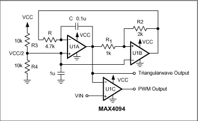

This usually involves a comparator fed with a reference triangle wave like this: -
Circuit from here.
But you can use an LTSpice voltage source set to produce a triangle wave if you wanted and just use the comparator indicated by U1c in the above.
