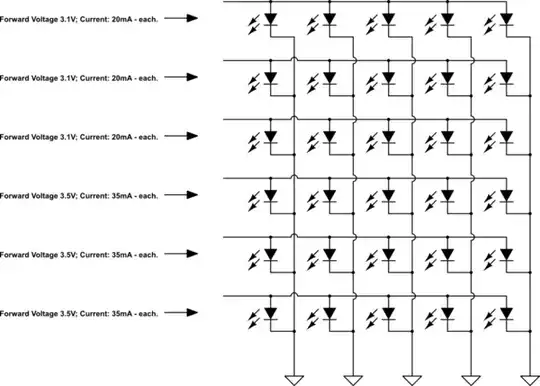

I'm quite new to electricity and electric components. I'm building an LED matrix from scratch on a small PCB. I will be using an IC for multiplexing, Transistor for controlling external power supply besides Arduino, resistors and of course the LEDs.
Now, my general question is - power supply of what type(constant-current vs constant-voltage) and what values(Voltage + Amps) should I buy?
My PCB with already soldered LEDs looks like following:
  • 3 parallels of - 5 3mm blue LEDs in series. Forward Voltage 3.1V; Current: 20mA - each.
  • 3 parallels of - 5 3mm white LEDs in series. Forward Voltage 3.5V; Current: 35mA - each.
Now, after reading tons of articles on Current, Voltage, power sources and so on, there are still questions to which I don't have definite answer. I want to understand the core of all these, so I have following questions:
1) Can I power all 6 parellels, meaning whole PCB with one power supply? If I have understood correctly, I can not. I will need a separate driver for each of the LED color. Correct?
2) How should I calculate the driver values. In my understanding - 5(LEDs in series) x 3(parallels of blue) x 3.1(V each LED) = 46.5V. For Amps, should sum up the values of all 15 LEDs also, or should I calculate by just one LED as the Amps are same across the circuit? To sum-up, I will need a driver of 46.5V / 20mA?
3) Should the same calculation be used for white LEDs, and then two separate power sources connected together somehow?
Please help me to understand not just the values of the power source, but also generally the idea behind the topic. Should I be considering something else into my calculations? Any advice for a better design? Thanks a lot.

  • Welcome to EE.SE! Please draw a schematic or what you are proposing. Click on edit and the schematic symbol. You will need current limiting, at these low levels, a simple resistor is easiest. – winny Apr 24 '20 at 16:40
  • WHy re-invent the wheel? – Tony Stewart EE75 Apr 24 '20 at 16:57
  • A schematic would help. – Leoman12 Apr 24 '20 at 17:05
    You’re schematic is different from how you explained your circuit. All of those LEDs are in parallel. This doesn’t look like a typical led matrix. – Leoman12 Apr 24 '20 at 17:19
  • Leoman, I have 5 LEDs in series. And 6 series in parallel. Maybe I did draw schematic incorrectly. – DemiA Apr 24 '20 at 17:23
  • @Demikooo but how should we know what you're doing if you make self-contradictory statements? fix your schematic. – Marcus Müller Apr 24 '20 at 21:21
  • As I said, I am very new to this, so I might be self-contradictory and all-contradictory too. Anyways, I can't fix the schematic. I draw one, but when I save It shows another. – DemiA Apr 25 '20 at 10:24

  • I added another picture because some-why when I save the schematic it does not save correctly. If your explanation is still correct for the picture then thanks a lot. Now it fully clear ;) – DemiA Apr 25 '20 at 10:43
  • It’s hard to tell what is connected to what in that picture. Check this link for what an actual LED matrix connections look like. Also you’re welcome if my info was helpful in this problem. https://www.circuitspecialists.com/blog/getting-started-with-an-led-matrix-tutorial/ – Leoman12 Apr 25 '20 at 10:57
  • Thanks, the link helped again. Added schematic now, should be correct now. – DemiA Apr 25 '20 at 12:25

No. What you have are 6 parallels of 5 parallel LEDs. Nothing is in series. This will not work well because there is no way to enforce the current through each individual LED. You should never solder anything until you have a completed design and know exactly what you are doing.

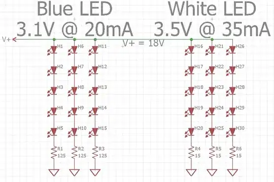

You haven't included how you plan to control the LEDs, so I didn't include anything in the schematic. I would recommend you research an N-Channel MOSFET switch which can easily turn your strings off and on.
One power supply can handle it all; you will just use different value current limiting resistors. On that note, you don't have to drive and LED at the rated current; I only do for illumination related projects, and then I overdrive them.
  • Blue LED String Voltage: 5 x 3.1V = 15.5V
  • White LED String Voltage: 5 x 3.5V = 17.5V
So you need an 18V rail for those White LED strings. I would highly recommend you redesign so you can use a lower voltage power supply, like 12, which is much easier to come by. Use more parallel strings with fewer LEDs in series.
  • Voltage across R1, R2, & R3 = 2.5V. For 20mA, use 125 ohm resistors.
  • Voltage across R4, R5, & R6 = 0.5V. For 35mA, use 15 ohm resistors.
Total Current = 3 * 20 + 3 * 35 = 165mA. If you add enough for your microcontroller plus some overhead, you would need an 18V, 250mA power supply.
