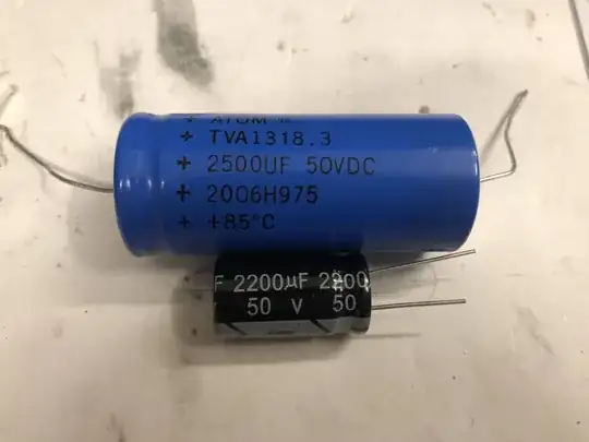

I'm recapping a vintage amp, and that amp has two larger caps at 2200uF @ 50V. I have sourced some possible replacements, and I'd like some insight into why these are SO different in size, and how I should think about that. (These are both new parts. Original cap not pictured. I know they are slightly different in capacitance--the schematic asked for one thing but the original part was another-- but I think the question here still stands since the specs are so close).
The big one is a Sprague Atom rated to 85°C. (data sheet here). The small one is a JWCO part rated to 105°C. (Data sheet here)-- it's over an inch long, which makes the Sprague huge at like 2.5"+ and way more diameter.
Now, I get that the JWCO is a sort of no-name commodity part that I don't want to use in an audio amplifier-- I get that. But even a Nichicon audio cap at 2200/50 is only going to be a bit over an inch long.
But what I don't get here is WHY these are so enormously different in size, and what's up with the Sprague? Small variances wouldn't surprise me at all based on materials and construction but this is not a small variance. Even the 50-year-old cap I'm replacing is much smaller than the Sprague (though not as small as the JWCO or a Nichicon).

    Different dielectric. Also possibly different ripple current rating. – DKNguyen Apr 22 '20 at 18:34
  • @DKNguyen Thanks. What does that mean for me as a user? Why should I care, esp about the dielectric, and for what purposes would I choose the larger size when I can use the smaller? Thanks – BZo Apr 22 '20 at 18:41
    @BenZotto You don't really for the most part anymore than you care how your cellphone works. – DKNguyen Apr 22 '20 at 18:42
  • I am willing to bet that the larger caps are only around because they are an older product line that has been extended, no reason to use them in new designs. I can't see any reason to use them – Voltage Spike Apr 22 '20 at 18:42
    Ripple current rating and ESR (or tan delta) are probably different. But I'm not seeing them in the Sprague data ... there must be fuller data somewhere. –  Apr 22 '20 at 18:43
  • Same question already probed..... https://www.antiqueradios.com/forums/viewtopic.php?f=19&t=349067 – Kyle B Apr 22 '20 at 18:43
  • It is interesting that for the higher voltage rated devices, even the 1uF caps are physically huge. I wonder if that series just uses large cases (possibly with empty space inside) for the higher voltage parts? – user1850479 Apr 22 '20 at 18:56
    I wouldn’t buy an electrolytic that didn’t have an endurance specified numerically. The Nichicon has 2000 hours specified and that is barely ok. The earlier two don’t have endurance specified hence, you can’t tell how long they will last in moderate temperatures. Buyer beware. See my answer here to understand why. – Andy aka Apr 22 '20 at 19:16

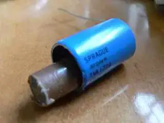

Alotta empty air... Those are very old designs (60's), one might use them to restore vintage equipment w/o affecting their appearance.
https://www.lespaulforum.com/forum/showthread.php?177151-Sprague-TVA-Atom-vs-Nichicon-VX-Series

    Good to know. Thanks. sounds like the Sprague Atoms are a bit physically unique in this respect, so all other equivalent (and equally appropriate) caps will be somewhere near that smaller size and that's nothing to worry about. – BZo Apr 22 '20 at 19:11

Generally speaking, manufacturing has changed significantly since the old Sprague caps were designed, so unsurprisingly there's a lot of blank space in that case. Aluminum electrolytic capacitors can have same specs / be different physically due to a few factors, including lifetime, mechanical robustness, and designed specifically with ESR/ESL in mind. Different electrolytes, layer thickness, encapsulation, electrolyte volume, venting, etc. can all be tweaked to make a component for a specific application. Audio capacitors, You would definitely need more of the electrical specs to know why two "equivalent" caps would be different sizes.
