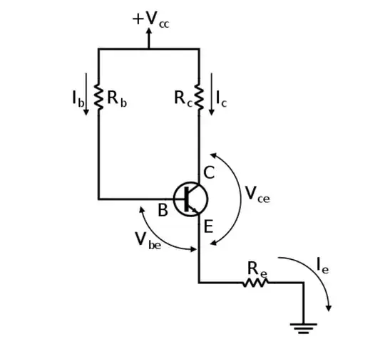

@wbeaty already gave an answer in regard to the voltage divider, and why you don't want to load it too much. But here's another way to look at it, and I think is relevant in BJT biasing. \$\beta\$ is not a constant (highly dependent on temperature) and thus it will make the collector (and therefore emitter) current, susceptible to the changes in \$\beta\$. This will disrupt the Q point of the amplifier.
Think about the following configuration, with an emitter resistor:
The collector current turns out to be:
$$ I_C=\beta I_B=\dfrac{\beta (V_{CC}-V_{BE})}{R_B+(\beta +1)R_E} \tag1$$
If you let:
$$R_B<<(\beta +1)R_E \tag2$$
And noting (as an approximation) that \$1<<(\beta +1)\$, then:
$$ I_C\approx\dfrac{V_{CC}-V_{BE}}{R_E} \tag3$$
That last equation is pretty much independent of the variability of \$\beta\$ so long as (2) is met. You could make that assumption, if for example, \$10R_B=(\beta +1)R_E\$, but that's just a rule of thumb (eg. you could make it a factor of 15 or 20). Note that this will work the same if you had an input voltage divider, instead of the single \$R_B\$ shown, those two resistors would combine into a Thevenin equivalent resistance, but the same concept applies.
