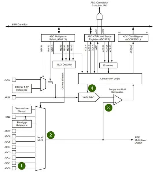

Let's look at the ATmega328P datasheet commonly used in the Arduino, etc.

Note that this pin is digital there is no connection to the analog to digital conversion circuits. If you check on page 63 you will find a similar diagram with an extra tap-off labeled AIOxn which goes to the circuit below. GPIOs with that configuration can perform as digital input or analog input. Each of the analog pins goes to the analog multiplexor.
Figure 2. The ADC circuit from page 105.
  1. The analog inputs 0 to 7.
  2. The output of the multiplexor. This selects one of the inputs at a time (under program control) to be converted to digital.
  3. The signal is presented to a comparator.
  4. A 10-bit DAC generates a sawtooth ramp signal1 and when it exceeds the signal at (3) the comparator switches indicating to the conversion logic that the current count is the analog value.
1 I haven't confirmed the exact working of this so read the datasheet if you want to be sure.

  • Slight nitpick: It's actually a SAR ADC, not a ramp. I'd be very surprised to see a different type of ADC in any general-purpose micro. This datasheet doesn't say explicitly, but the timing diagrams give it away. Pages 209-210. – AaronD Apr 13 '20 at 16:06
  • That's not a nitpick! As explained in my footnote I hadn't checked and I suspected that it might be successive approximation. What's the 'R' in 'SAR' for? – Transistor Apr 13 '20 at 16:21
