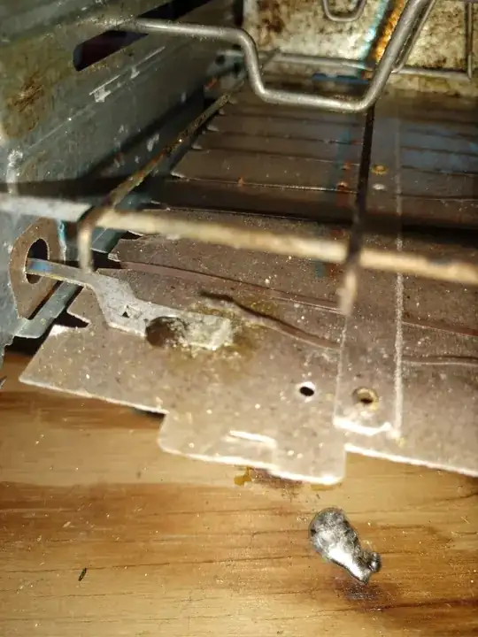

Is there any easy way to get this nichrome wire to fasten to the plate below it? Could I just tuck it underneath the plate, between the mica board?
Nichrome wire lifted away from rivet

  • You could try tucking it under the plate, and if you are lucky the arcing in operation might weld them together. Otherwise it's time to get a new toaster! – Bruce Abbott Apr 11 '20 at 22:46
  • Spot welder! You could make one using an old microwave transformer. – mguima Apr 12 '20 at 05:10
  • A steel bolt and nut might work, at least for a while. Do not use cadmium (bright plated) hardware, which would release poisonous fumes, and keep parts well clear of metal case. The hardware may eventually loosen from heating/cooling. – DrMoishe Pippik Apr 12 '20 at 05:41
  • "The Tuck" worked 100%. Six pieces of toast so far! Thank you! – juddmaltin Apr 13 '20 at 23:22

Tucking it between that silver tongue and the mica board worked great!
So far, 6 pieces of toast and no fires.
