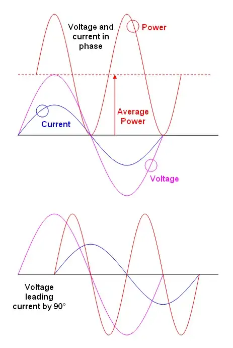

Following on from your previous question, I have taken the picture and reduced it to focus on the relationship between voltage and current for a resistor (top) and a pure inductor (bottom): -
In the top diagram the power waveform (red) is wholly positive i.e. it never drops below the "zero" line (black). This means that power is never returned to the source i.e. it is all converted to heat.
In the lower diagram, current (blue) lags voltage (magenta) by 90 degrees and, the resulting power waveform (red) straddles the zero line perfectly. This means that power is put into the inductor during the time when current magnitude is rising and then, when current magnitude is falling, power is taken back (power is negative). Average power is zero.

  • "This means that power is put into the inductor during the time when current magnitude is rising and then, when current magnitude is falling, power is taken back (power is negative). Average power is zero." this reactive power is taken back by the source in the form of inductive kick by the inductor? @Andy aka? – Alex Apr 11 '20 at 12:08
  • @Alex correct.. – Andy aka Apr 11 '20 at 12:10
    The positive power means that we are "absorbing" power from the source (circuit), the charging phase. Negative power means that the inductor is releasing power back to the source (circuit), discharging phase. – G36 Apr 11 '20 at 12:11
  • this reactive power is taken back by the source in the form of inductive kick by the inductor? @Andy aka? G36? – Alex Apr 11 '20 at 12:12
    @Alex it's not a DC circuit so I wouldn't call it a kick. – Andy aka Apr 11 '20 at 12:13
