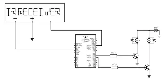

I am trying to make a remote control car using an Arduino Uno and IR receiver modal VS1838B. The system worked as planned except that IR receiver gets erratic after any one motor spins.
  • upon starting up, all functionalities works as planned
  • after 1 motor spins , the IR receiver will barely receive.The light on the receiver will stop blinking until the motor stops.
  • If I disconnect the motors, the IR receiver will receive normally.
I suspect that there is a current affecting it after the motor starts spinning
I've included my circuit diagram below.
  • Pin 11 connects to IR receiver
  • Pin 5 activates the transistor for the left wheel
  • Pin 6 activates the transistor for the right wheel
  • The power source for the IR receiver is different from the motor
  • All the ground actually connects back to the UNO ground. Simplified it below.

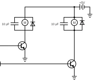

  2. I am not sure how to place the ceramic capacitor, so I drew a diagram of what I think it could be. Is this correct?

    Great block diagram. Now please put some details about what there is connected to IR receiver. Any other components not shown? Filter on IR power supply? Pull-up resistor on IR data pin? Is it a bare IR module or some board with the aforementioned components built-in? – Justme Apr 07 '20 at 13:31
  • Your diagram is deeply flawed, the connections you show between the Arduino and the IR receiver cannot be right. And you need to supply full details about the power source for the receiver and arduino. – Chris Stratton Apr 07 '20 at 13:54
  • @ChrisStratton: I think he's got it connected right, and that he just made a quick block diagram without precise connections specified. I can see that he flipped the polarity on the IR, and connected the negative side of the IR to the positive 5V on the MCU. – Edin Fifić Apr 07 '20 at 14:04

    @EdinFifić Thanks a lot for your extremely helpful reply. I have done a quick experiment which I've shared above. I have also edited the question with a new question on the placement of the capacitor. Would love to know if its accurate. – Joshua Apr 08 '20 at 12:16
    @Aaron I updated the question with a question on capacitor placement at the motor. Thanks for the help. – Joshua Apr 08 '20 at 12:18
    Yes, that is a correct placement of the capacitors. Just try 100nF ceramic disc first to see if it's enough, then move to higher values. – Edin Fifić Apr 08 '20 at 13:47
  • @Joshua yep that's the correct placement. Try to get them as close to the terminals as possible with as short of leads as possible. Every millimeter counts. – Aaron Apr 08 '20 at 17:43
  • @Joshua there is also this question, which covers the motor capacitor topic: https://electronics.stackexchange.com/questions/19517/why-connect-capacitors-to-motor-body – Aaron Apr 08 '20 at 17:46
  • @EdinFifić sorry for the very late reply. It works extremely well now. – Joshua Jan 03 '21 at 10:58
