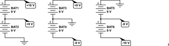

n DC circuits, we say that the negative terminal of battery is considered as ground(0V).
Sometimes.
schematic
Figure 1. Two 9 V batteries series connected but with various grounding options.
Even in a DC circuit we can call any point ground. It's just a reference point from which we take readings.
But in AC circuit, the polarity of voltage change continuously but what is ground in AC circuits with respect to which polarity changes? Please also explain the concept of ground in circuits in little bit more detail. In books, this concept of ground is not taken into account.
For AC measurements your meter only measures magnitude of an AC voltage. Again when taking measurements we need a reference point. This is usually the neutral which has been "neutralised" by connecting it to Earth at the supply transformer.
schematic
simulate this circuit
Figure 2. For AC we have the same situation as with DC but with no sign - just the voltage magnitudes.
When working with AC, therefore, it is common to measure the voltages from the neutral point. In Figure 2 we can connect any one of the three terminals of a centre-tapped transformer to Earth and then take voltage readings at the other terminals.
