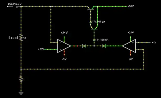

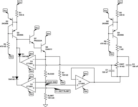

Below picture is a simple voltage regulator(link to simulator):
The current at the op amps output is at nA region(why?), how can I increase the current at the op amps output without adding a third transistor with high gain?

  • Who is supplying normal, operating base current for the NPN Darlington section? – jonk Apr 05 '20 at 06:54
  • You should use the schematic editor that is available on this site, so that the parts are labeled. Also, have a look at this and answer the big question shown there. – jonk Apr 05 '20 at 07:08
  • @jonk The link that you provided is just picture not an answer... – ElectronSurf Apr 05 '20 at 07:59
  • It was a question, not an answer – jonk Apr 05 '20 at 08:00
  • @jonk I don't even know what ISRC is! – ElectronSurf Apr 05 '20 at 08:02
  • Oh. Sorry. It is a behavioral current source. In reality, these don't exist as actual parts but are instead replaced with a few active and passive parts that achieve similar behavior. – jonk Apr 05 '20 at 08:05
  • @jonk It's my first try on transistor configurations and I don't know much about biasing it. do you mean that I need to feed current to the transistor base using a voltage divider for example? – ElectronSurf Apr 05 '20 at 08:10
  • Can you explain what you are trying to achieve? Is this for something you want to make? Or just learning? – jonk Apr 05 '20 at 08:10
  • It can just be a resistor, but it might also be more complicated. – jonk Apr 05 '20 at 08:12
  • @jonk I'm trying to learn while building a voltage regulator, problem is I don't know how much and how to increase the base current at the op amps output. I can just simply add another pair of transistors but I know it isn't right because I've seen it done with just two transistors... – ElectronSurf Apr 05 '20 at 08:13
  • I don't have time right now, but perhaps someone will help. I think you have a lot to learn, right now. So you'll need a detailed answer. – jonk Apr 05 '20 at 08:17
  • @jonk Oh ok, thanks. – ElectronSurf Apr 05 '20 at 08:22

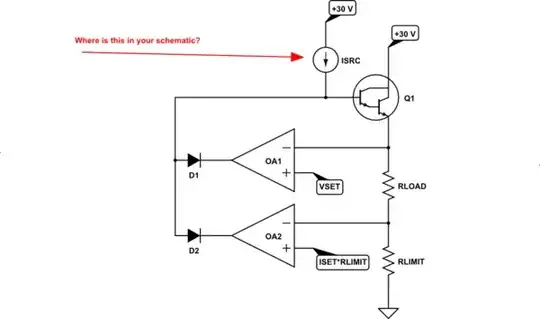

Point 1 -- The meaning of "behavioral" in the context of a current source.
You didn't know what ISRC represented in the schematic I presented to you in the comments. This one, shown below:
schematic
The fact that you couldn't work out the meaning tells me a lot about what you haven't yet encountered, or thought about. So this kind of "resets" things back a bit. That's why I commented that you have a lot yet to learn.
As mentioned in the comments, \$I_\text{SRC}\$ is a behavioral current source. When I use the word behavioral I mean that it "behaves like," with the added implications that whatever it is isn't an actual circuit element but instead is a model or idea of some circuitry that behaves like a current source (in this case.)
There are a lot of things that "behave like" a current source. For example, a simple resistor can behave (poorly at times, better in other circumstances) something like a current source. The resistor works better like a current source when one end is tied to a actual voltage source and the other end is tied to something that is mostly like yet another voltage source. Neither end needs to be tied to a perfect (behavioral) voltage source. But it helps a lot when both ends are tied in a way that the voltage across the resistor is, to a rough degree, fixed in magnitude.
In cases where that cannot be guaranteed, more circuitry (usually including active components like transistors or ICs) is needed.
And sometimes you can live with a really crappy current source that isn't very good, but is "good enough."
The main thing is that you should be able to understand from the above circuit that I'm "hand-waving" in the direction of something where the more it looks like an actual current source the more manageable the rest of the circuit is likely to be.

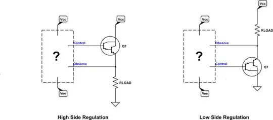

Below here are both kinds:
schematic
simulate this circuit
There are times when low-side regulation is used, though more often the low side is about regulating a current-limit instead of providing voltage regulation. But both methods work to regulate the voltage across the load resistance. And if you get enough experience, you'll see both methods are used.
For example, in your circuit exhibited in the question, you illustrated high-side voltage regulation with low-side current-limiting. I just wanted to get these terms drilled into your head so that you aren't flummoxed when you see them used.
A final note at this point. Note that I added \$V_\text{EE}\$ on the schematic. This is there because sometimes the "blob" inside that dashed box (the unknown stuff) needs access to a voltage that is below ground in order to provide sufficient voltage headroom. For example, if you wanted to be able to control/limit the current down to something very, very close to zero (or zero exactly) then there would be no remaining control headroom if the dashed box didn't have a still more negative source to work with in making its observation and providing information to the other part that then operates the controlling output.
Point 3 -- Returning to your schematic

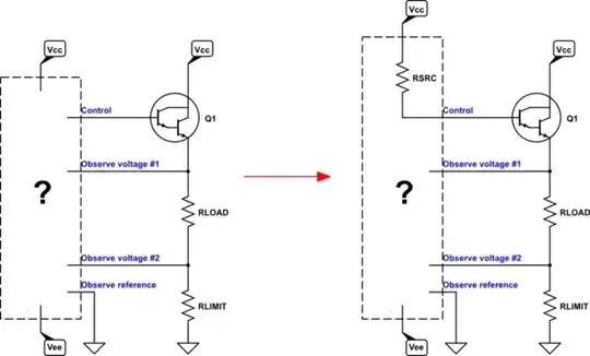

Your schematic uses high-side voltage regulation and low-side current-limiting. The behavioral model might be drawn like the blockish diagram on the left. I've also added a very simple change to the diagram, shown to the right, which adds a resistor I'll talk about in a moment.
schematic
Note that the dashed block is observing two voltages, managing a control output, and has access to a pair of voltages which should be wider apart than the range you require for the load itself.
On the left side, there's nothing present to turn \$Q_1\$ on so that it can actively supply power to the load. It needs access to base current to settle the recombination debt inside \$Q_1\$. The easiest way to supply that base current is to hook up a resistor as shown on the right. At least this can get the ball rolling. Of course, this is completely uncontrolled operation. It supplies a base current but there's nothing actively adjusting that current. So this is obviously incomplete. But at least we've gone from "not on" to "on."
Before we go further, there's another problem. The control line that touches the base of \$Q_1\$ will have to have a voltage on it that is perhaps somewhere between \$1\:\text{V}\$ and \$3\:\text{V}\$ above the load's voltage (plus a little extra needed for \$R_\text{LIMIT}\$.) Since you are considering (I think) a variable power supply, this means that the voltage across \$R_\text{SRC}\$ can vary a lot. Which means the amount of current it is sourcing is varying, as well. And this places some further difficulties on the rest of the (currently unknown) circuitry. (For example, it might overwhelm the opamp's ability to soak up the extra when regulating a very low voltage for the load.) So we really don't want a resistor there. We'd prefer a current source. Let's add one.

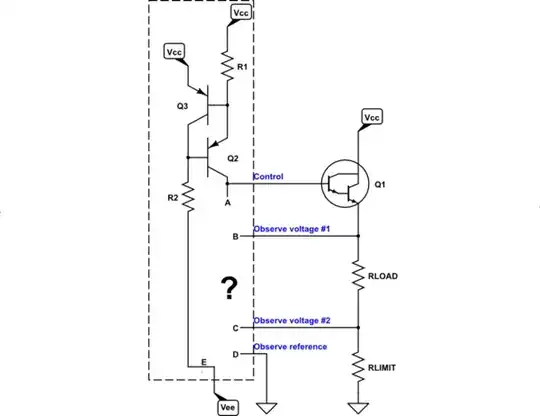

schematic
I've added a two-BJT current source to the circuit. One of the BJTs measures the current and the other one is carefully controlled to supply it. For annoying long details on designing one of these (instead using NPNs for a current sink -- the ideas remain, though), see the link here. The nice thing about these is that the current can be regulated well enough that it works fairly well and it's cheap and doesn't take up a lot of space. It's not a perfect current source, though. But for something like this purpose, it's fine. This circuit's current source magnitude will remain fairly stable regardless of your desired output voltage for the load. So it's a "nice to have." And a lot better than a resistor by most measures. Plus, it allows the rest of the circuit to have a current source value that is dependable so the design can proceed knowing what it has to deal with, later.
What should this current source supply? Well, perhaps 3-4 times as much as you imagine that \$Q_1\$ will require. An advantage of \$Q_1\$ being a Darlington is that it requires less current to its base for a given load current than a singleton BJT would require. The disadvantage is that it has a larger voltage drop required. But in this case, with say \$30\:\text{V}\$ available and if you don't need more than say \$24\:\text{V}\$ on the output, then the Darlington is probably fine.
By the way, the 2-BJT current source does, itself, have some voltage headroom requirements -- something on the order of \$1.3\:\text{V}\$ to about \$1.5\:\text{V}\$, or more. So here is yet another one of those "voltage headroom" details. In combination, the current source and also \$Q_1\$, you may require perhaps as much as about \$4.5\:\text{V}\$ headroom, which takes away from your \$30\:\text{V}\$ supply rail. And if the supply rail itself has "ripple" on it and may droop to say, \$28\:\text{V}\$, then this might suggest that you cannot be certain to supply more than \$28\:\text{V}=4.5\:\text{V}=23.5\:\text{V}\$ to the load. And even that has to be further discounted, based upon the voltage drop required by \$R_\text{LIMIT}\$ when operating at the maximum allowable current.

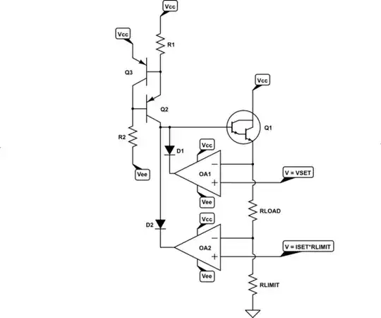

Now, at this point I think we can add in some of what you already had in place.
schematic
I haven't plugged in values for the resistors, but the other link helps you work through the details for that part. Just make sure that the current source doesn't provide more current than your opamps can sink -- the opamps should be capable of sinking many times more, in fact, than you are supplying there.
For a Darlington arrangement, and say a maximum current of \$2\:\text{A}\$, you would expect a base current that is perhaps \$1\:\text{mA}\$ or so. So the current source needs to provide more than that -- perhaps 3-4 times as much. And many opamps can sink \$5\:\text{mA}\$ and more. So it should be okay.
Thoughts
There's been no discussion above about dissipation in the various components. Obviously, you'll need to worry about \$Q_1\$. But \$R_\text{LIMIT}\$ may need a bit of attention, just in case.
And now you can see why I wondered, at the outset, about what was supplying base current to your Darlington. Nothing was, in your schematic. And now you can see what I wanted you to think about adding.
The remaining problem, and it's non-trivial, is how you might arrange to supply the two opamps with appropriate voltages that may be independent of your load. For example, suppose you set a specific, regulated voltage with reference to ground into \$V_\text{SET}\$; with a value that accounts for the drop in \$R_\text{LIMIT}\$ for some given load. If the load changes, then the drop across \$R_\text{LIMIT}\$ also changes, while your \$V_\text{SET}\$ remains fixed. This means that the voltage across your load varies a little, depending on the load itself. That's not usually considered a good thing in a power supply that is supposed to be providing a fixed voltage for your load.
Let's look at a cut-and-paste solution to allowing a potentiometer to provide a \$V_\text{SET}\$ that provides a set voltage across the load that remains set, regardless of the load value itself (assuming the current-limit doesn't kick in, of course.)
schematic
As you can see, using a potentiometer can be a little more complex than you might otherwise imagine. The added opamp provides a virtual voltage reference for the potentiometer. \$C_1\$ provides a little jitter protection for the potentiometer wiper and \$C_2\$ and \$R_4\$ stabilizes the voltage across the potentiometer. I've added \$R_7\$ as a cheap way to deal with the case where you've removed the load, completely.
And the circuit still doesn't set up a potentiometer for the current limit, which will also need a way to make it remain stable, independent of \$V_\text{CC}\$ ripple. Which means still more parts, though you may avoid another opamp as the ground doesn't need to be buffered.
At first, it seems that all you need to do is toss in a couple of opamps and it's great. But it really turns out that there's a lot more to it, than that. Also, I'm not recommending your approach here. I'm just trying to make it work better, given that you'd want to keep it.
