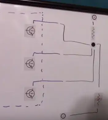

Inputs: Base of bjts
Output: black node
When at least one of the inputs is HIGH the output is LOW.
This is clearly NOR. Then why everyone calls it Wired-OR?
across
  • 1,150
  • 26
    Because of the way it is used, I guess? If you interpret LO output as true then it is X or Y or Z that is HI (HI being interpreted as true for inputs). – DKNguyen Apr 01 '20 at 14:14
  • @DKNguyen but logically it's still $\neg (X\lor Y\lor Z)$ right? You want to interpret it as active low output. Interesting... – across Apr 01 '20 at 14:19
    Yes. I'm, talking about language though. It's much rarer when you interpret HI as true for both inputs and outputs and use it as "when output is true, then X nor Y nor Z are true." – DKNguyen Apr 01 '20 at 14:21
    the mistake your making is assuming the encoding of TRUE and FALSE is always correspondant to HIGH and LOW – vicatcu Apr 01 '20 at 14:21
    More egregious distortions of logic have happened...like current flowing from positive to negative. – DKNguyen Apr 01 '20 at 14:32
    it uses active low inputs ... a low voltage represents a 1 – jsotola Apr 01 '20 at 14:43
    If the input being driven were active high, I'd call that a wired-AND connection, not wired NOR. When discussing wired-OR and wired-AND connections we don't worry about whether the logic driving them is inverting or not, only how the wires interact with each other. – The Photon Apr 01 '20 at 15:22
  • It's an OR because the condition being detected is detected when any of inputs are asserted. The output is normally high and active low, while the inputs are normally low and active high, but that doesn't affect the semantic meaning of the signals. – Matt Timmermans Apr 02 '20 at 02:20

  • Thanks again Peter:) the noise immunity at the input was higher (3V as opposed to 0.8V in the low state). Is this because when the input to a TTL NAND gate is $0$, the forward biased input diode sees 0V on one side and 5V on the other side. But when the input was $5V$, the reverse biased input diode sees 5V on one side and 5V on the other side. Clearly the diode is barely reverse biased when the input is 5V, thus the noise immunity when the input is 5V is low. Hope I get this right. Thanks so much for your awesomeness:)) – across Apr 01 '20 at 15:14

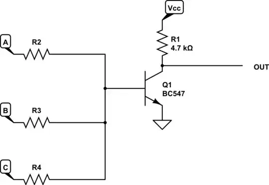

This is an alternative representation of that wired-Nor using a single transistor.
schematic
