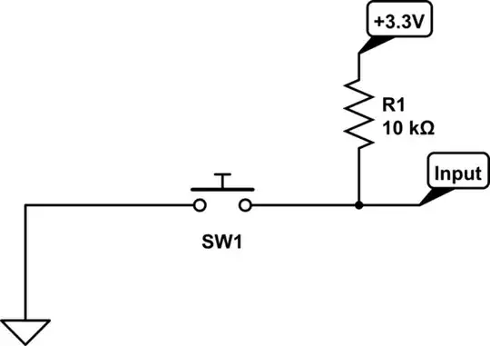

Say we have the following setup
schematic
Input is pulled high and current flows through it as long as the switch is open. As soon as it closes current switches to the path of least resistance and goes through the switch to ground.

    Your first case will be same as second case if you replace SW1 with low resistance like 0.01ohm when closed. Depending on the input voltage, the current will take both paths. There will be V/10k current through the 10k resistor. Current will take ALL the available paths based on resistance. – across Mar 30 '20 at 12:16
  • 18
    Current never "choose[s the] path of least resistance", it travels all paths proportionally to the resistance of the path. – Tom Carpenter Mar 30 '20 at 12:18
  • In your first example, current still flows through the resistor, then through the button, then to ground. – Tom Carpenter Mar 30 '20 at 12:19
  • @TomCarpenter yes but not through input which is then tied to ground respectively, thus it effectively chooses a path. – php_nub_qq Mar 30 '20 at 12:20
    @php_nub_qq you haven't defined what the input is, but current will still try to flow through it, even if it is an infinitely small amount. – Tom Carpenter Mar 30 '20 at 12:26

In your first example, the switch when closed has orders of magnitude less resistance than the input. The current division ratio will be so close to 100% to the switch, that we engineers approximate it to 'all through the switch'.
In your first example, when the switch is open:
  • Current will try to flow from 3.3V, through R1, then through both the switch and the input.
    Yes, I know, sounds odd. But the thing is, although the switch is open, it is still a resistance, just an infinitely high one, so the current will be infinitely low (zero in the ideal case, but not necessarily zero in the real world).
    Depending on what the input is, noticable current might flow through that, or if that is open-circuit, an infinitely small or zero current will flow.
When the switch closes:
  • Its resistance drops dramatically to a very low value. Now more current can flow from 3.3V through R1 through the switch to GND. A noticable amount now - around 0.33mA.
    Again depending on what the input is, current will still try to flow through that. Whether it is infinitely small, or some measureable value, who knows.

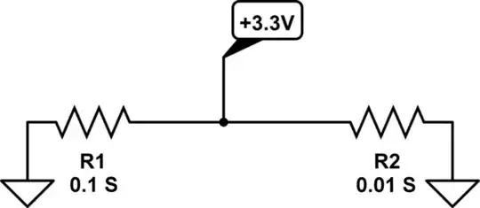

Meet conductance
Conductance is a unit you never think of, even though you almost work with it all the time.
Conductance is 1 / resistance.
The unit is the siemens. Yeah, like the service equipment. (Some people call it the "mho", but I think those people work for Square D :)
You have a 10 ohm resistor. What is its conductance? 1/10 siemens.
"Path of least resistance" is wrong. It's used by business managers and motivational speakers because it's nicer to say than "I don't have to outrun the bear". The actual rule is
Current flows on all paths simultaneously, in proportion to their conductivity
Pardon the graphic. The schematic editor won't support this.
Current splits 10:1 down those two paths.
In parallel paths, conductance adds. So the total conductance here is 0.11 S.
Easy peasy, when you think in conductance!
In the first case, when you close the switch you are connecting vin directly to ground. If you had Vin coming through some other circuit, you would notice a current coming through that element too . In your circuit when the switch is open , depending on Vin the current might flow through the resistor ( Say if Vin is 3.3v and the switch is open no current is going to flow ). Current will flow through all resistors which have a potential difference across them. If Resistance is small current is going to be more through it ( which is the case of the second schematic).
