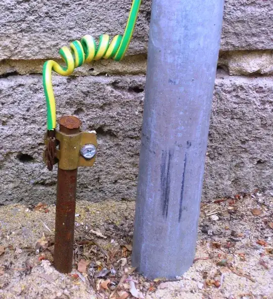

Your building/home should have a ground/earth stake. Sometimes called an earth rod, its a metal spike going into the ground.
If this has been removed or disconnected then your home is no longer code compliant and needs fixing urgently.
Look around for something like this:
From wikipedia
It should NOT look like this:
