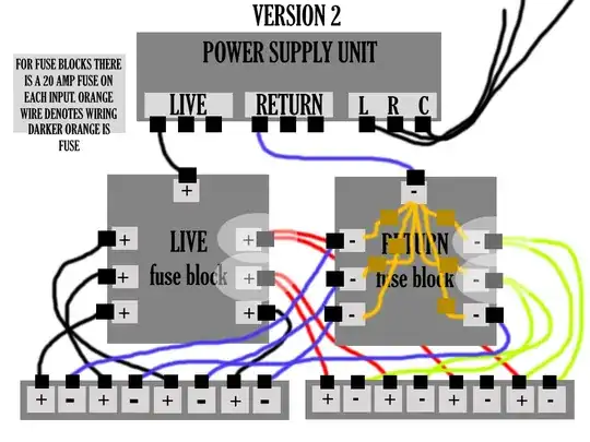

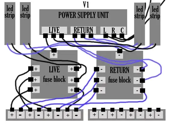

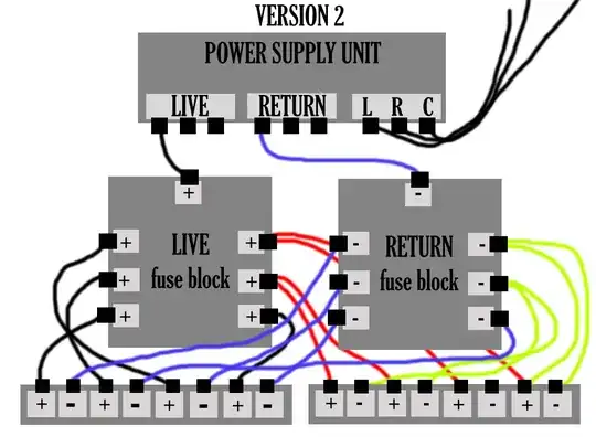

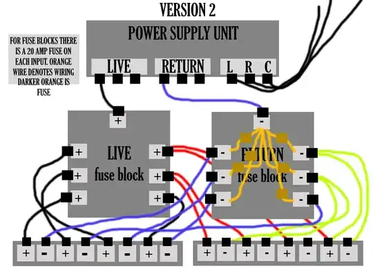

I have a couple questions about my DIY LED installation.
  • Both FUSE BLOCKS have 20 amp fuses inline each input to the main terminal which leads to the PSU, so 6 to 1, each having a fuse inline such that both live and return have fuses.
  • Also I have ran this in real-world testing with my DMM so my math is of real world experience, these are visual lights so not full white. Also I limit them to 200 out of 255 in programming.
  • The last picture denotes my area of concern: What happens to my math at these posts while configured like I have? Also my lights are powered on one side, so a parallel circuit (right?).
  • Now I have read a lot—I mean a lot— saying to power both sides, but the manufacturer even says you don't need power on both ends, so I choose that route for less soldering and wires.
My lovely Photoshop drawings, enjoy:
V1 IMAGE
V2 IMAGE
V2 IMAGE
V2 IMAGE

Now in my first picture supplied, not V2, my lights lit up efficiently and safely. I ran them for 24 hours and my wires never got hot. Yes I did overkill (way overkill) on purpose as my solder skills are above average, so no shorts.
Will my V2 work efficiently as the first one when I switch over with the "CONSOLIDATION" of wires with the added second BUS BLOCK, thus bringing the spare LEDs to a BUS BLOCK and freeing up other terminal posts? Now with this alteration, I have connected (2) sources to (1) terminal block that once had only (1) source.
My strips do not have a closed loop // the LIVE and RETURN are only fed at one end.
I'm basically confused about what I'm doing to my circuit. Will it perform properly? I am not interested in changing up my circuit completely, as I have made a bunch of custom wiring for it, but if I am completely lost, please let me know.
Once again, the final question is: Will my (V2) drawing work for my 4 LED fixtures (8 strips @ 120 LEDs) @ 300 available PSU watts?
My math shows I'm at 96 percent at (V1) drawings, but when I make this alteration to the wiring and having two sources on on post, what does that do to my math?

Your diagrams are a little confusing. The effort is appreciated, but the critical bit that's missing is how the fuse blocks are wired.

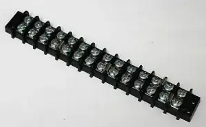

A terminal block as you have at the bottom of your diagrams, is commonly used to make connections between wires. But how the terminals connect to each other varies wildly. A "distribution block" would typically have several terminals connected electrically together, whereas a "terminal block" is just a more general term for these connectors.
For example, here's a terminal block where two wires can be connected to each other, but each set of two screws are isolated:

Multiple Wires from a Terminal
Your last image shows how you've doubled the wires from the positive fuse block out to two terminals and you express concern about doing this. I presume you are running LED strips from each of these wires (one enclosure or "aluminum extrusion" on each wire).
The problem that this introduces is that one fuse is now inline with two strips in parallel. If a strip pulls 14.4A, then two in parallel pull 28.8A. (Current usage is additive when connecting loads in parallel.) This means a 20A fuse will blow when no problem actually exists; in other words, the fuse will be under-sized for the load.
A single fuse should be connected serially with the load it is protecting.

    Looking at your diagram, you have eight total connections from the positive fuse block. Assuming these all connect to LED strips capable of pulling 14.4A each, that's a total of 115.2A. The single wire from your power supply to the positive fuse block then must be capable of carrying that current safely. Your choice of 10 AWG is good here (assuming that it is a short length).
